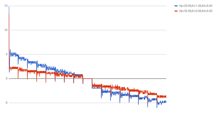

PID Controller Software Upgrades
Over the last two weeks community member Kevin Keegan has continued to consistently turn out a series of massive contributions to make Maslow better. I’ve been pretty overwhelmed the last couple weeks with rushing to roof the POD before the rains started and getting ready to ship the next batch so it’s not an overstatement to say that he has been fully carrying the software development and doing so phenomenally well. He started last week in version 0.92 by making a series of changes to the way the PID control system works.  The new system makes a number of significant improvements. In Kevin Keegan’s own words from the pull request the changes/improvements include:
  • Removing the running average on the input to the PID velocity calculation (this caused oscillations and damped the control reaction and I think averaging is an incorrect solution in control theory anyways)
  • Adds a minimum rotation rate for the velocity controller (the motors are unable to turn at this rate, so this only caused integrator windup and noise)
  • Ensure that position requests are equal to a whole number of encoder steps (prevents oscillations and integrator windup for unobtainable positions)
  • Fix delay in the straight line loop in the movement loop to be consistent (ensures that the controllers are getting steps of equal length in each cycle)
  • Fix a few other obscure design issues with the PID controller
The net result of which is that firmware version 0.92 makes the machine faster, smoother, and more accurate as shown in the tests below.
This graph shows the error in the velocity controller from -16RPM to 16RPM in 2RPM increments. The results of the prior system are shown in blue and the new system in red. In an ideal world, this line would be as close to zero as possible.
 Test description and plot by Kevin Keegan

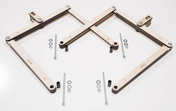

Linkage Kits Available
Logan Needham has made a kit available for his ingenious linkage system which we have discussed in previous updates. You can pick one up from his Etsy store while supplies last: https://www.etsy.com/listing/558743441/maslow-triangulation-linkage-kit
The linkage kit works to simulate the behavior of the chains meeting at the router bit which dramatically reduces the complexity of calibrating the machine, improving accuracy.
 The linkage kit operates on the principle discussed in past updates where the chains are made to behave as if they meet at the center of the router bit. Photo by Logan Needham
He has also put together a beautiful wiki page with instructions for putting the kit together which you can find on the wiki here:
https://github.com/MaslowCNC/Mechanics/wiki/Triangulation-linkage-kit-assembly-instructions
 The parts of the linkage kit. Photo by Logan Needham
This kit marks the first time someone has taken Maslow’s technology, improved it, and made it available for sale. For Maslow to have the kind of impact that we think it can, we know we can’t do it alone. If we keep seeing the kind of brilliant, well executed improvements that Logan Needham has done with the linkage kit, the future is bright.
 The assembled linkage kit. Photo by Logan Needham
