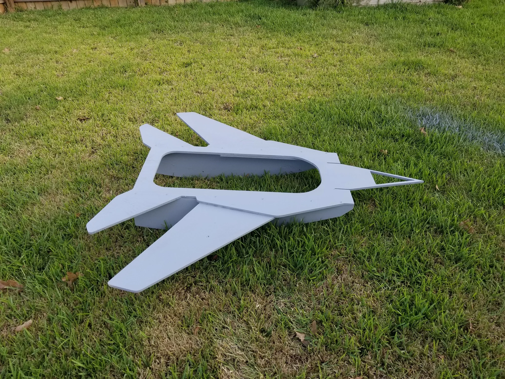

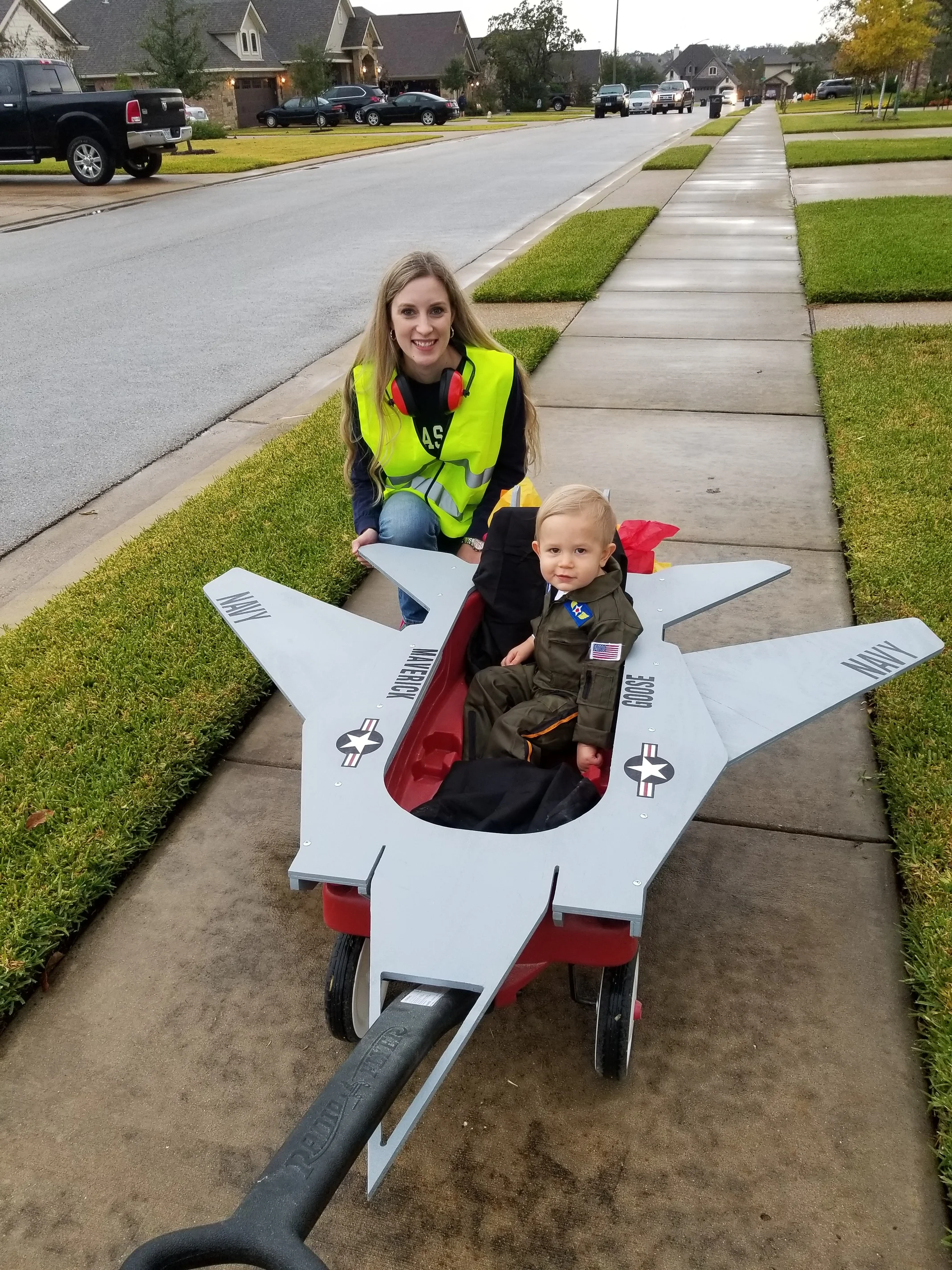

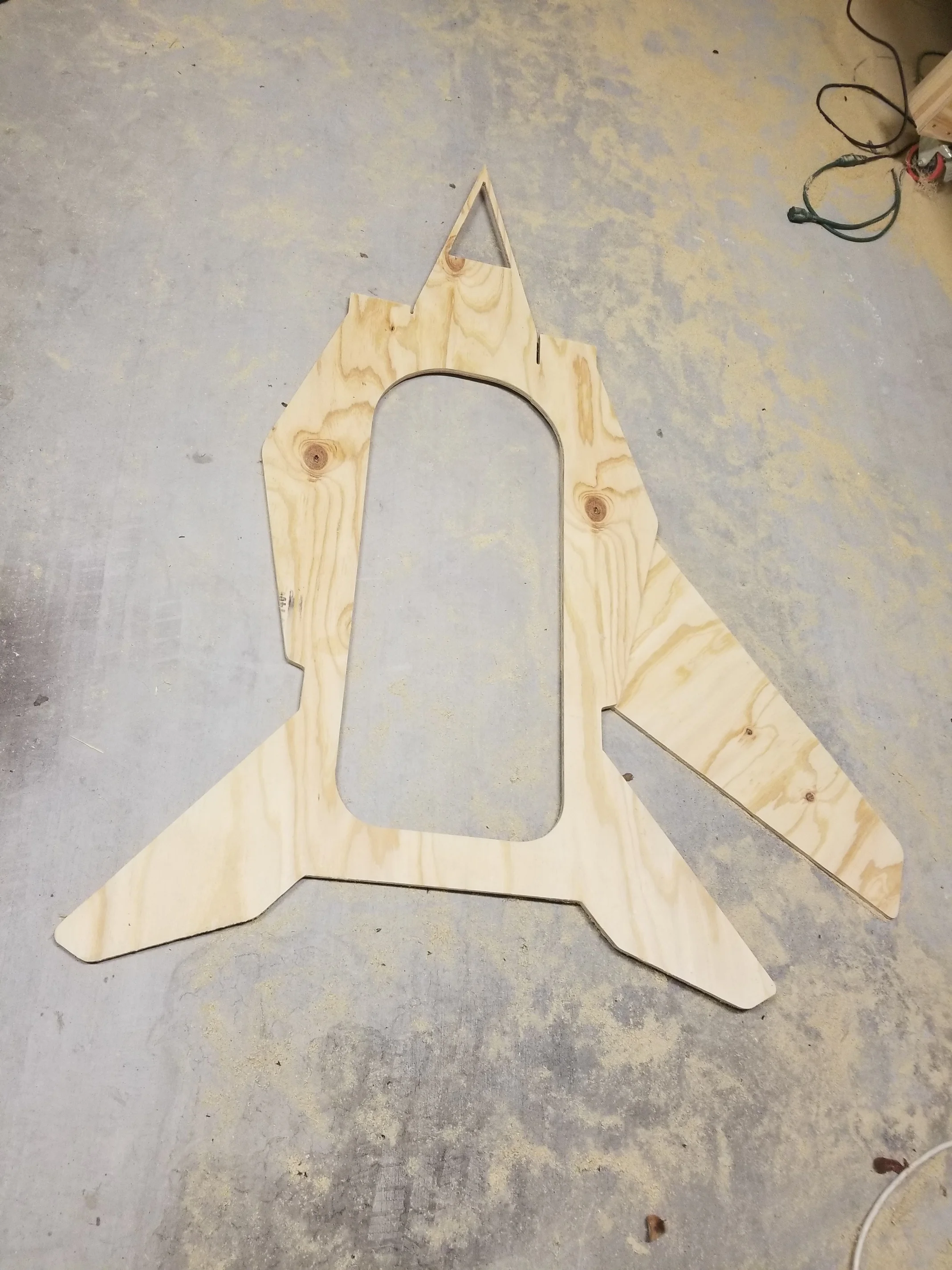

I’ll start off with one of my all time favorite forum project posts. If you would like to read the whole story directly, you can find it here(https://forums.maslowcnc.com/t/halloween-project-help/748) The short version is that community member GMS10 posted asking if anyone would be willing to help him with the CAD drawings to make his kids red wagon into a fighter jet for halloween. In a matter of hours community member Jakrro knocked it out of the park by coming up with a beautiful CAD drawing which he posted to the forums.
  Fighter jet red wagon design by community member Jakrro
GMS10 took those drawings and did a phenomenal job making a real life mini red wagon fighter plane which became part of the most adorable family halloween costume. Great work guys! That kind of teamwork, sharing of ideas, and collaboration is what Maslow is all about!

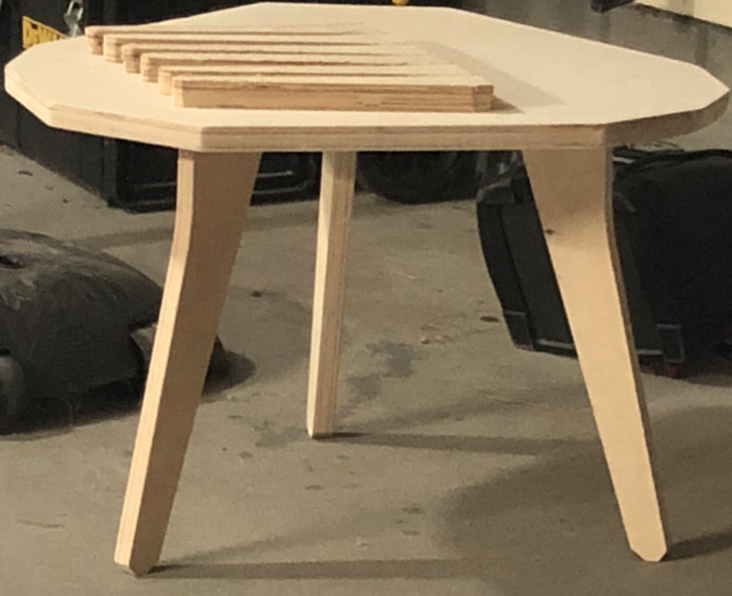

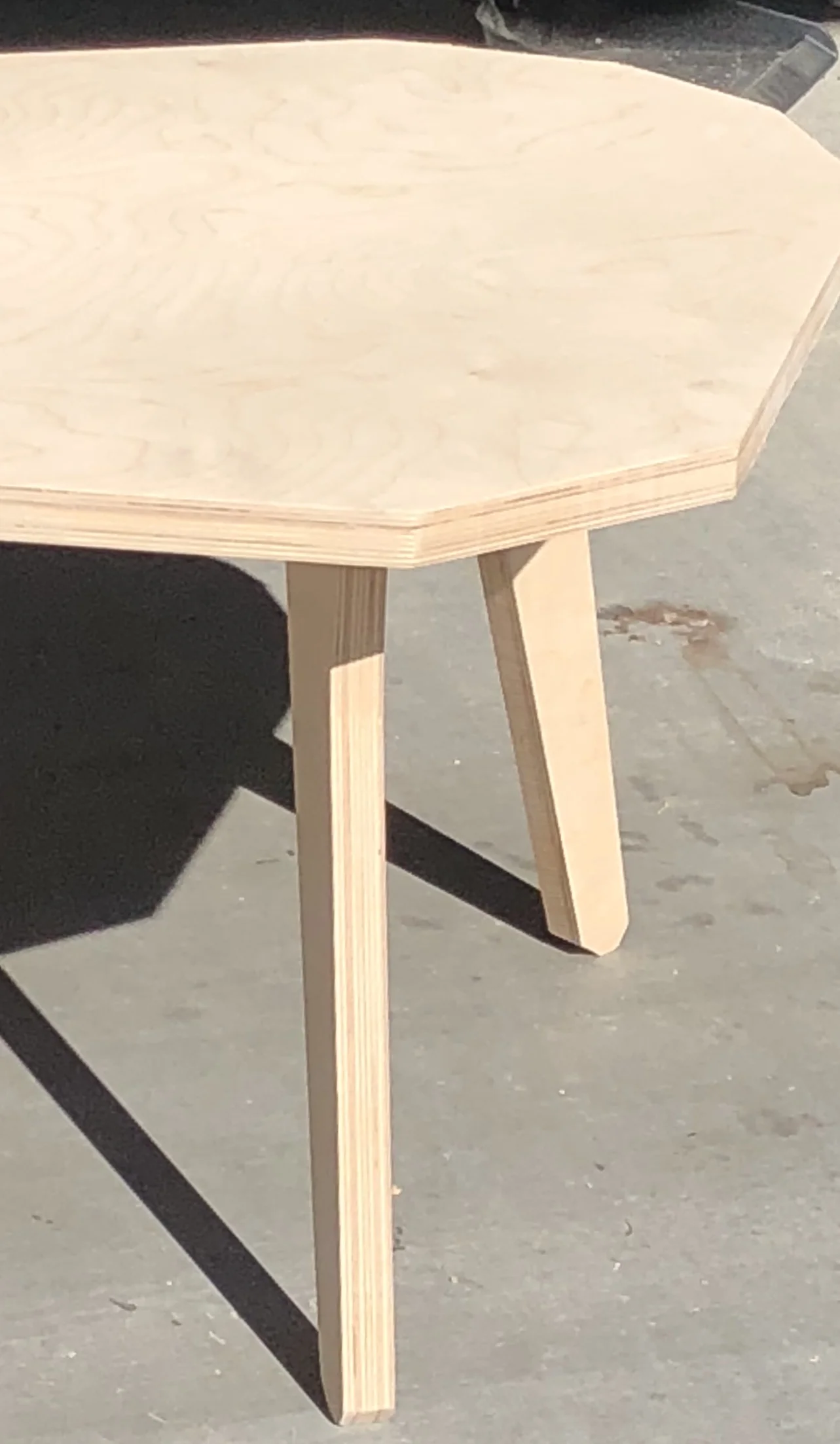

Community member Clintloggins built a complete Eddie Set of a table and three stools from Open Desk this week. I’m particularly excited to see his build because I am going to take on the similar Cafe Table to go with the chairs I just made.  You can find the files to build your own set here: https://www.opendesk.cc/edie/edie-set .
