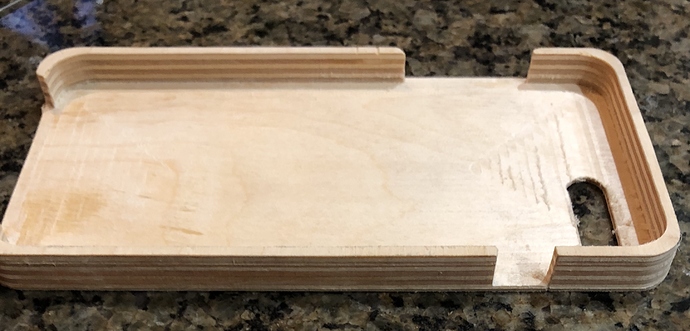

This week community member @clintloggins cut this beautiful i-phone case. He’s not sure he’ll use it as a phone case, but it is a beautiful build none the less. You can read all about it here:
