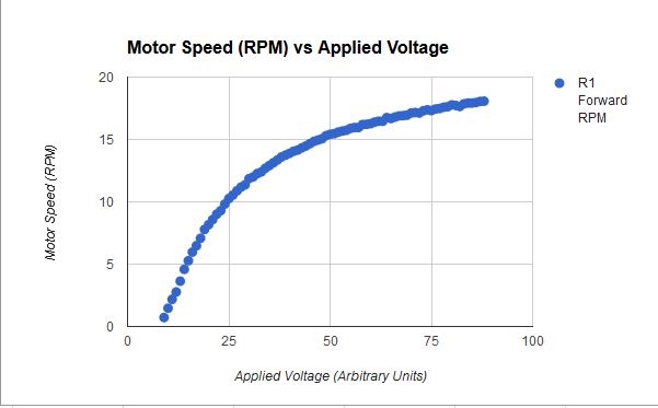

       While the closed-loop control system was critical to making the machine as low cost as it is, it also brings with it a number of interesting advantages that we can exploit. Because the controller knows the exact speed of each motor and how much voltage is being applied to the motor, the controller in essence has a real time measurement of how much torque is being applied by each motor. This could be used for all kinds of interesting applications like detecting how much force is being used to move the bit through the wood to do real time feed-rate adjustments or detecting if the machine has bumped into something to turn the machine off automatically.
      The first application I’ve begun exploring is using the feedback system to allow the machine to calibrate itself to different motors or different router weights. We expect that many of you will modify your machines or even build your own from different parts entirely and we want to make sure that the machine automatically adapts to give the best performance for your setup. By measuring how much force is required to lift the router, the machine can in essence “weigh” the router sled and adapt its behavior accordingly.
 Here you can see the Speed vs Applied Voltage curve for the standard motors as measured by the controller.
