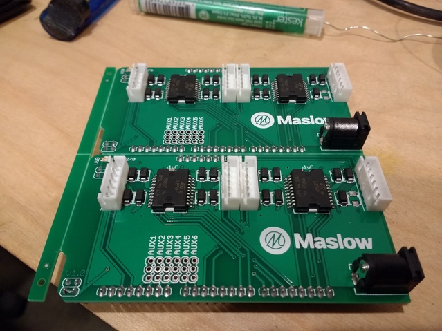

The Arduino Shields, which were the last part we were waiting for, arrived yesterday morning with a missing diode on each board in addition to the missing connection issue we described in our Feb 8th update. We’re not sure why the diode was missing, but we will talk to the factory and find out. We rushed them pretty hard to get us the boards, so likely the issue is the result of haste. Fortunately, we had enough spare diodes on hand to replace the missing one by hand. We also added a small wire to each to bridge the missing connection. We stayed late into the night to get them all prepped and ready to send out first thing this morning. As a reminder, all of our beta testers will receive the updated Arduino shield when we ship kits to everyone in addition to any other parts we change .
 Arduino Shields missing one diode
 Arduino Shield with missing doide replaced and connecting wire

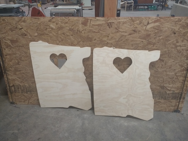

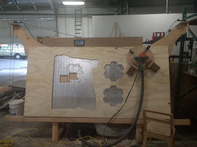

The project was a challenge because it was the largest single piece we have cut yet. The coat rack was much taller, but these boards were both tall and wide using almost a full sheet of plywood for two. Other than the notable issue described below in the “What Went Wrong” section they cut well.
 Corn hole board cutting smoothly after fix described in "What Went Wrong" section
Hannah hasn't had a chance finish the boards yet in the rush to get the kits shipped, but we can’t wait for summer so we can play!

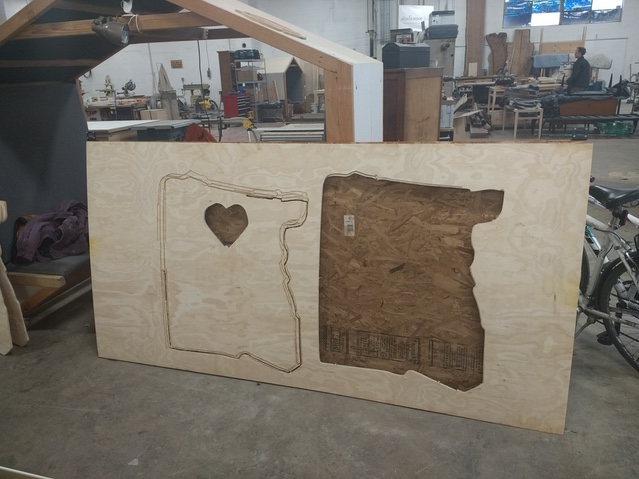

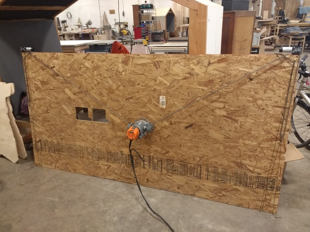

This week we encountered a really interesting bug while cutting the corn hole boards. It took the better part of a day to figure out what was happening because it was so strange and seemed impossible. When cutting the first board, we noticed that with each pass, the router seemed to lose track of it’s position and jump by about ¼ inch as if the chain slipped forward one link. I initially wrote off the idea of the chain slipping because that’s not how chain works and investigated a software problem. Eventually when I couldn't find anything in the software I watched each part of the machine very carefully until I saw what was happening was that in fact the chain WAS slipping.
 The multiple paths taken by the router are visible on the left cutout. This was mostly done while trying to track down the issue.

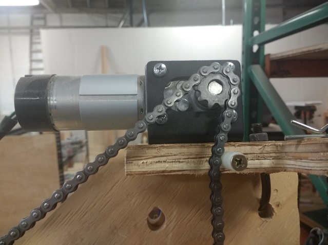

A part of the Oregon coast called Coos bay had just the right shape to cause the chain to rock back and forth in just the right way for it to move forward one link. You can see the chain slipping in action in the video below.
Adding a second set of chain rollers seems to solve the problem, but we will keep an eye on it.
 Testing adding a second roller to improve chain feeding
