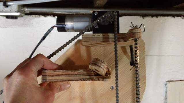

A few members of our community expressed an interest in hearing more about what went wrong each week, so here are a few different lessons were learned in the making of the nightstand. The first was that it is indeed possible to send the machine off of the frame. Although initially this “send-off” seemed like a huge problem to Hannah, Bar was able to cut and reattach the new piece that had broken in less time than it took Hannah to redesign a new style of leg for the nightstand. This in itself is something that we think makes Maslow so awesome; that it can reconstruct itself! Check out the photo below to see the mangled piece being held up next to the newly constructed and attached piece. Since nightstand construction on monday, software limits have been added to prevent the machine from leaving the 4'x8’ work area in the future.

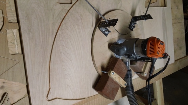

Another lesson that was learned via cutting the nightstand was about heat dissipation in the motor controller. Bar has been testing heat sinks, and Hannah’s choice to cut the legs high and in the center of the plywood (see image below) was a good chance to get a big test in, and to discover that the issue was just as much about heat dissipation as it was about calibration. At the top center of the sheet tension in the chains is the highest and the motors have to work the hardest.  To compensate the software needs to give the motors more power at the top center to keep them operating at peak efficiency. More and more is learned with every cut that we make, and we can’t wait to see that multiply when Beta Testers get the Maslow into their hands.
 The legs being cut high and in the center of the sheet.

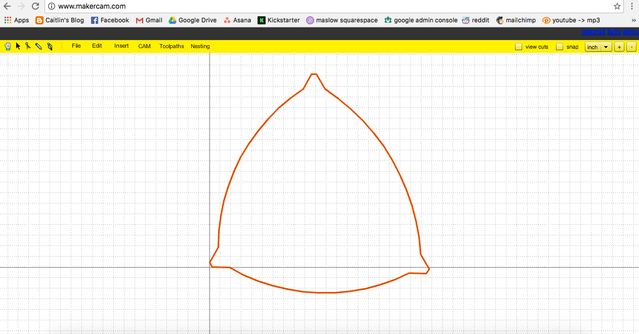

A final lesson that was learned during the cut of the nightstand was the best way to go about placing a cut on your piece of wood before starting. When you are using makercam.com, the location where the X and Y axis cross is the same as the “origin” in Ground Control. It’s best to place your design strategically around the origin in MakerCam so that when you go to define your origin in GroundControl you will know where the design will be in relation to that point. This may seem like an obvious point to some, but it’s incredibly helpful when you’re working with a small area on your plywood and trying to make the most out of each piece (see image below to explain what we were working with).
 In this image, the nightstand top is strategically placed with one corner at the point where the X and Y axis cross, or the origin. When you click “Define Origin” in GroundControl, you know that the cut will appear in the same location as it was saved in MakerCam, ie; above and to the right of your defined origin.

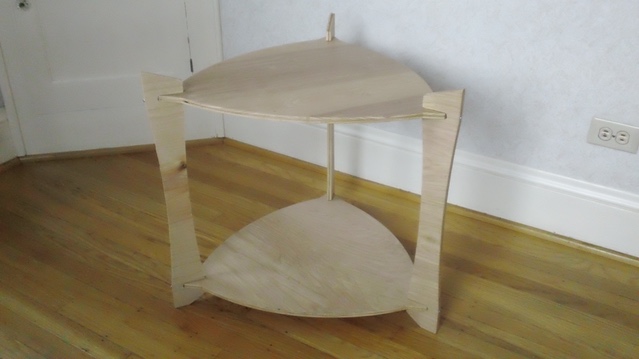

 The finished product! It came out exactly as desired :)

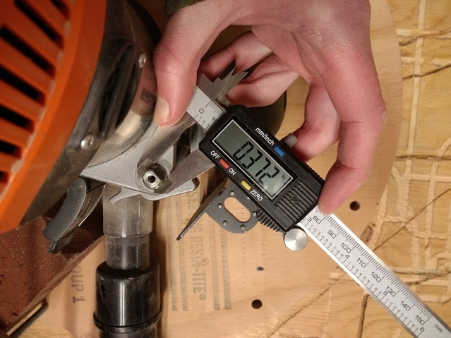

Now onto the z-axis! The z-axis will be available for purchase through our website with next week’s update on the 8th. We want the z-axis kit to easily interface to as many routers as possible. Each router can have a different size shaft which the motor needs to attach to. This week, we wanted to get a survey of which shaft sizes are most common among our backers’ routers so that we can supply the correct shaft coupler sizes. We don’t plan to supply the correct shaft coupler for every type of router, but we’re hoping to stock 3-5 different sizes so that we can cover most of our backers’ needs.
See the image below to understand how to measure the size of your router’s shaft.
Please follow the link below to submit the size of your router’s shaft.
Shaft Coupler Survey

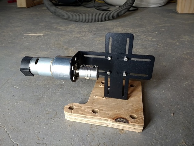

The z-axis will be $60 as promised. It will include a gearbox/motor/encoder, a 360cm (140 inch) cable to connect to the motor controller, two adjustable motor mounting brackets, a shaft coupler, and the necessary bolts and nuts to mount the motor and brackets and allen keys for the set screws and bolts. Because we chose to upgrade everyone to a 4-axis controller board no additional electronics are needed to make the z-axis work.

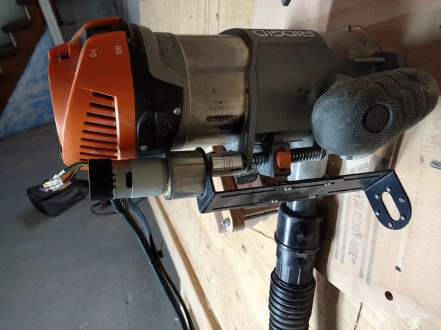

We have done our best to make the assembly easy to adapt to your router design as possible. The motor has an offset shaft allowing it to be positioned close to the body of your router and the brackets are designed to be adjustable allowing the drive motor to be moved vertically or rotated sideways to accommodate either vertical or horizontal adjustment mechanisms.
As much as we have done our best to make it easy to adapt to your router we can’t guarantee that every router will work well. Some router designs lend themselves more easily to being automated than others. It is up to you to decide what’s right for you, but as always you can find guidance and a community to share ideas with in the forums.

Here is a close up picture of the z-axis fully assembled.
