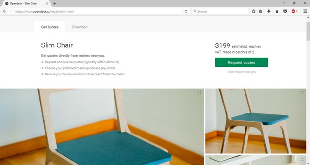

One great resource for furniture designs is OpenDesk, a London based furniture maker which shares all of their designs for free and manufactures them using a network of CNC owners around the world. You can check out their whole design catalog here: https://www.opendesk.cc/designs .
For this week’s project I will be making the Slim Chair. I think the design is elegant and I actually need a chair.
The first step is to download the plans from the OpenDesk website. Plans for any of their designs can be download from the “Download” tab at the top of the page.

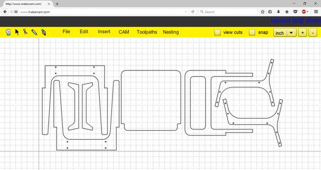

They provide .DXF files so I converted the .DXF file to a .SVG file for MakerCAM. I used the program Q-CAD to do the conversion (free, open, Window Mac and Linux - https://qcad.org/en/)
Next I opened the files in MakerCAM and used all the same settings as we showed last week to set up the cut. Because the original file is in millimeters and MakerCAM works with inches or centimeters you will want to resize the file by either 10x (mm to cm) or 25.4x (mm to in). This can be done by selecting all the parts and clicking edit -> Scale Selected.

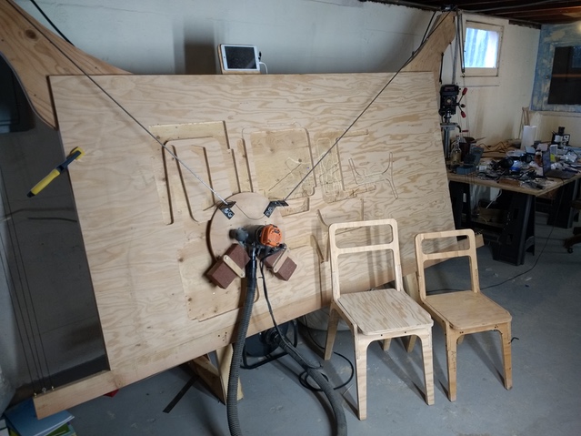

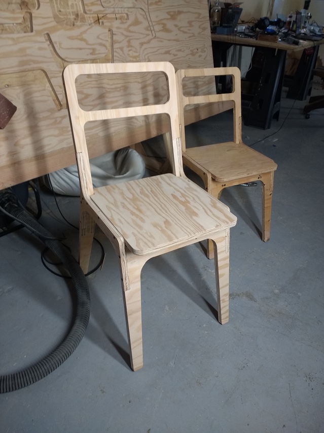

From there it was just a matter of pressing “Run”. Just kidding, I tripped over the USB cord part way through and had to cut one of the side braces separately. I also encountered a bug while cutting the chair seat and decided to re-cut it. I also messed up the millimeters to inches conversion on my first go around and ended up with a slightly too small chair (but we don’t need to talk about that).
Here’s a quick video showing some real-speed and time lapse footage of the cutting process. You may notice in the video that I am testing a new sled design. The new design replaces the router’s base plate with a much larger one cut from wood. The early results are good with improved stability and much improved ability to move across cavities in the wood left by previously cut parts.

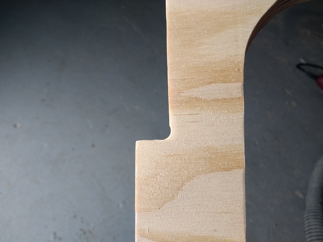

One of the nice things about building someone else’s design is that you have the opportunity to appreciate their craftsmanship. I particularly liked the way this design used a slight pump in the cut to allow the right angle on one piece to fit. It’s a common practice to do it that way, but I thought this implementation was particularly subtle.
