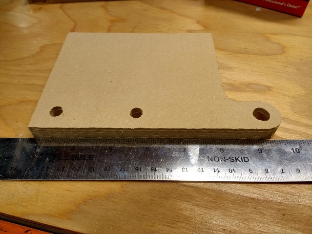

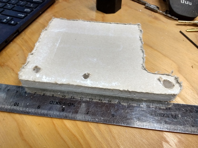

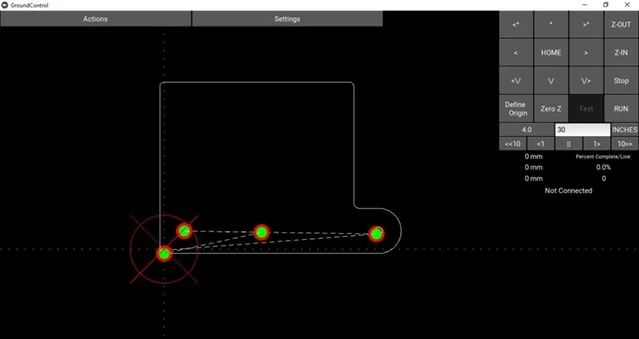

For each of the tests I decided to cut out one of the motor mounting plates. It’s an interesting shape with small circles which make errors apparent, as well as curves, and straight lines which make it a good test candidate.
 Motor mounting plate in Ground Control
All of the tests were done with either a ¼ inch two flute spiral up cut bit, or a ½ inch 45 degree engraving bit. In each test the part is shown in the photo exactly as it came out of the machine with no attempt to clean up burs or sand edges.

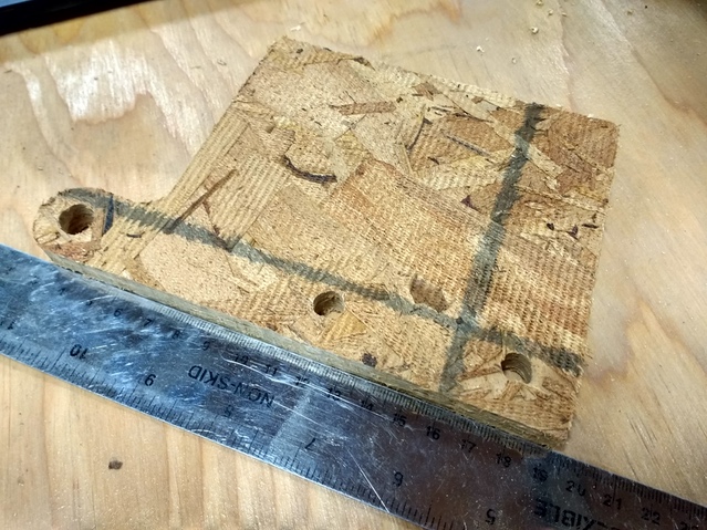

OSB: Cuts decently well, more splintering than with plywood because the strands seem to be less well bonded together. I wouldn’t build a dresser out of it, but as a structural material, the cuts look good. It smelled a little funny while cutting, so I would recommend good ventilation if you are going to be working with OSB.

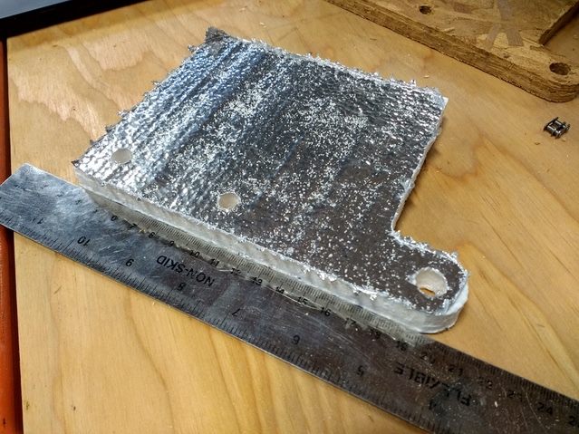

Rigid Insulation Foam: There are two types of rigid insulation foam, one is made from small foam balls similar to packaging foam and has a silver reflective foil on it, the other kind is made from a single sheet of foam with no noticeable balls and is generally a bright color (pink, blue, etc). I chose to test the kind with the small balls because I know from previous experience that the colored kind works well but makes awful dust. I was a little worried that the balls would split rather than cut, but cut quality was generally pretty good. The foil tended to pull away from the cut a little bit but that was the only issue.

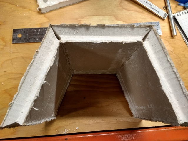

Drywall: Drywall cut much better than I expected it to, and the dust extraction system made for a remarkably clean experience. The paper backing on the sheet rock pulled away from the cut similar to with the insulation foam, but a quick slice with a razor knife can take care of that.
 Drywall
Drywall

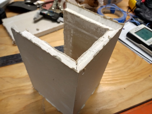

Watching this (https://www.youtube.com/watch?v=eump3ODx9iU) youtube video inspired me to try to see if I could get drywall to bend the same way they did. I didn’t have quite the right router bit, but after a little touch up with an exacto knife I’m pretty pleased with the results especially on the very first try.
 Unfolded drywall
Unfolded drywall
 Because my engraving bit wasn’t quite tall enough the drywall couldn’t fold completely
 After a little trimming with an exacto knife it closed

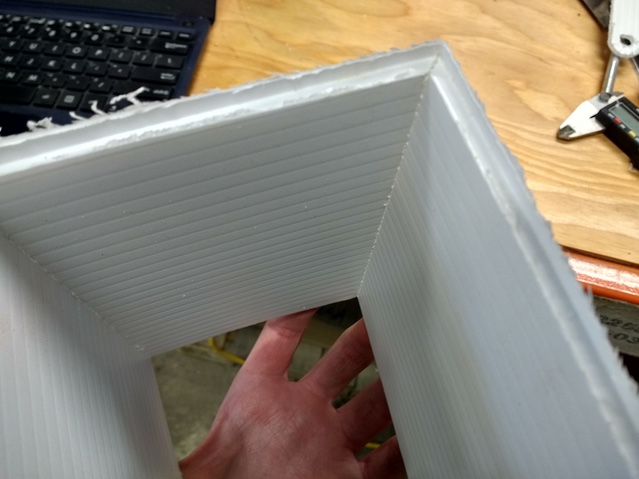

Coroplast: Coroplast cut quite well but seemed to result in less accurate cuts than I expected. Cutting the ¼ inch material in a single pass was not an issue, but notice how the mounting holes are not perfectly round. Less obvious in the picture is the fact that the straight edges also are less straight than in the other materials we have tested. It seems like the sled is sticking to the surface, possibly due to static electricity. The interior corrugated structure may also be a factor. More investigation is needed.
 Coroplast
Coroplast
I decided to try the same “score and fold” technique that worked with the drywall with the coroplast and it worked well. The groves were less clean looking than in drywall, but I think it would be possible to build some very cool structures this way.

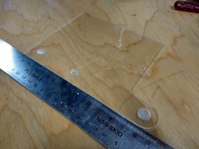

Polycarbonate: Polycarbonate cut well other than a little bit of a blunder on my part.  When I ran the test I hooked up one of the chains to the sled with a 360 twist which didn't agree with the sprocket so I had to redo this test. You can see the scar from where things went wrong on the finished part. I cut the polycarbonate in 3 .05 inch passes because I read online that people sometimes have issues with the plastic melting. I didn’t see any melting. I also tried something new which was to attach the material to the machine with double sided tape. It worked much better than I would have expected with the one exception: cutting through the material and into the tape gummed up my end mill quite a bit.

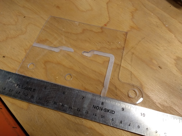

Acrylic: I bought only enough of both the acrylic and the polycarbonate to do only one test each and I messed this one up a little too. On this test I set the bit depth too shallow and only cut part way through in the interior holes. Other than that user error, acrylic cut well.

MDF: MDF is known for cutting beautifully and it does. You can see the mark left by each pass on the side of the part. A quick brush with sand paper would clean these off.
