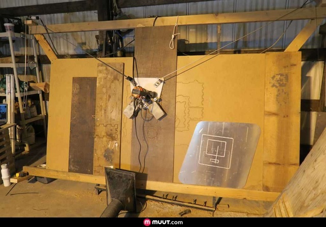

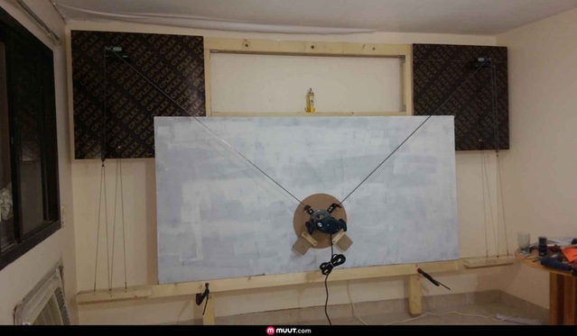

On to the fun stuff! As I said previously, we’ve been really impressed by all the work our beta testers have put into the Maslow so far. One of the coolest things we’ve been able to see are all the different frames our beta testers have constructed for their Maslows. Check out all the photos below, which were uploaded to our forums.
 The frame of forum member blsteinhauer

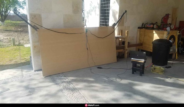

 The frame of forum member mexicomillionaire

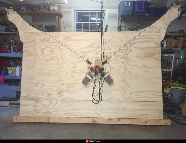

 The frame of forum member makermark

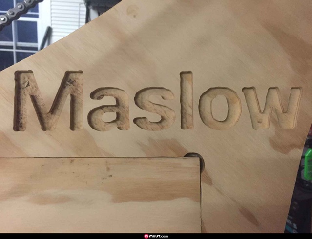

 Makermark engraved his frame with the Maslow name and logo!

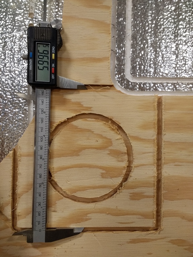

Thanks to some amazing work and testing by forum users rexklein, scottsm, rancher, blsteinhauer88, gero, makermark, and davidlang I think we've narrowed down the causes of the oval circles we've all been seeing. You can read the whole transcript of our exploration process here, but the gist of it is that we created a test shape and ran it under different conditions to narrow down what was causing the issue. It seems like if you use any dimensions settings other than the defaults right now you get strange behavior like oval circles. To prevent more confusion, we've constrained this week's version of Ground Control to use only the default settings. Regardless of the dimensions of your machine it's best to stick with the defaults this week while we find a solution. For the best results, move your motors to match mine which are spaced 2,978mm apart. If you have any questions, please let us know in the forums!
 Our test shape (a 6in square) once the calibration issue was tracked down
