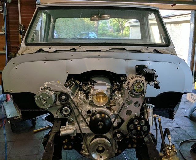

The project of the week was done by forum member rexkelin who is rebuilding a 1970 Chevy C10 truck.
He is using his beta machine to help with some tricky dash and engine bay sheet aluminum work.
Here you can see that he did not just one, but two revisions of the engine bay. Because the design was digital he was able to do a second iteration built on the design of the first. You can read the whole forum thread here.

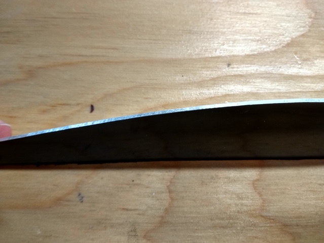

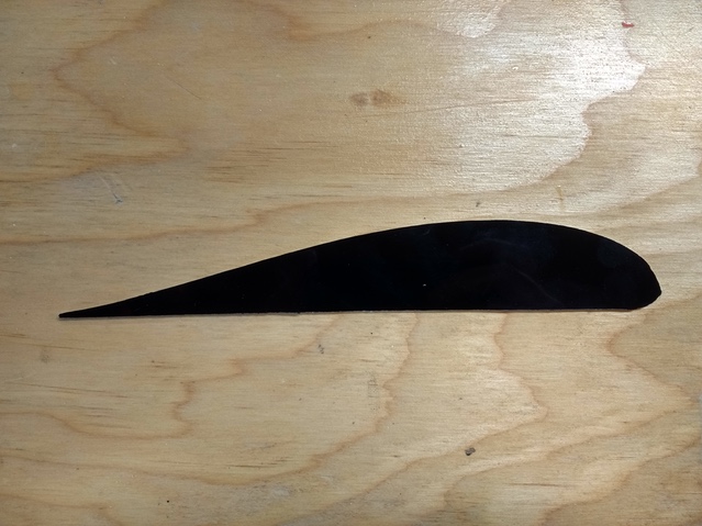

I was initially skeptical that Maslow would be able to cut aluminum. It’s been on my “to test” list for quite a while, and when one of our backers mailed me some aluminum sheets to test I had no excuses. Encouraged by rexklein’s beautiful work in the forums I decided to give it a go.
I chose a 1/4in single flute carbide end mill, with a feed rate of 35 inches per minute and a step down of .01 inches. I haven’t played around with other combinations, but this one worked much better than I expected.
I chose to cut a mini wing cross-section (it was just a test) from a sheet of 1.5mm aluminum of unknown alloy. The black color you see in the pictures is a protective coating on each side of the sheet.
You can see the raw footage of the cut in progress by clicking here.
I was hoping to edit it into a nicer video, but the footage is pretty unusable because of the camera focus.
Maslow may never machine blocks of aluminum the way you would in a machine shop, but for sheet aluminum projects it could be a useful tool. Yet another example of our community making the project better!
