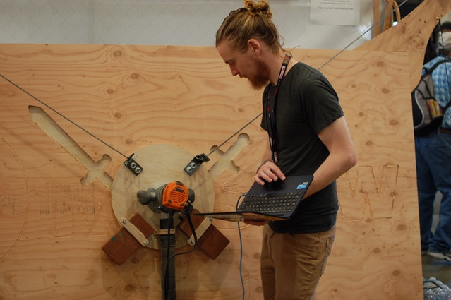

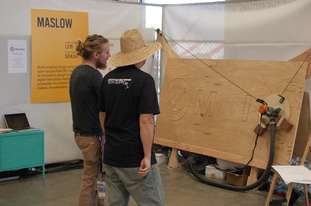

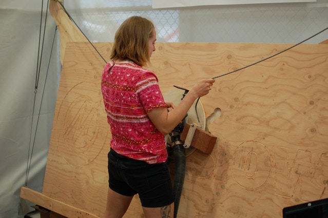

Our demonstration item was to cut swords for kids, which was a huge hit. Possibly too big of a hit. Sometimes it felt like we were in the children's sword business.
Our space was in the larger Kickstarter booth which we shared with some amazing Kickstarter projects. We had a chance to meet the creators of Circuit Scribe (a conductive ink pen), Teensy (a small and powerful dev board), and NeoLucida (drawing assistant). Getting to meet Paul, the creator of Teensy, was particularly cool because I’ve worked with his boards in the past and Maslow relies on his open source encoder library.
We also had the chance to meet many other significant people in the world of CNC. Our booth shared a wall with CNC Router Parts, ShopBot was across the aisle, GlowForge was just a few more booths down, and next to them was Shapeoko.
Thanks to Zach from Kickstarter and Hannah’s cousin, we got a few good photos of us in action at our booth. Check them out below.
