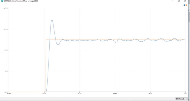

There are two branches that will let you experiment with tuning the machine’s PID loops yourself.
The first branch can be found here: https://github.com/MaslowCNC/Firmware/tree/tune-velocity-PID-branch
When you install this firmware the machine will command the motors to step through a series of speed changes, and will plot the result for you. It’s a good idea to remove your sled and chains before running this process because the machine is just setting the motor speeds, it is not thinking of the sled position.

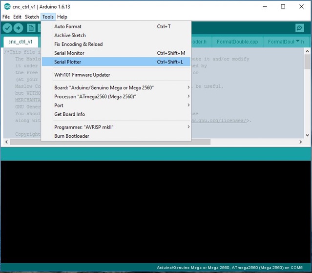

To open the plot after installing the firmware click Tools -> Serial Plotter from within the Arduino IDE. Note that the drop down in the bottom right of the plot window has to be set to 57600 to properly display the data.
 Opening the plot from the Arduino IDE
 The motor responding to a step change in speed. Units: RPM
You will see a plot like this as the motor steps through speeds. The yellow line shows the motor’s target speed while the blue line shows the motors measured speed. Notice how the motor “learns” about its own response over time so later responses are better than earlier responses. Try applying some force to the motor and watch as it corrects. Or try changing the values of _Kp, _Ki, or _Kd in the file MotorGearboxEncoder.h line 44.
 Change these values and watch the response change

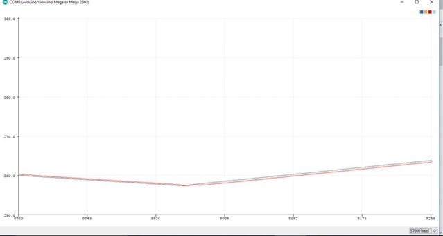

The second firmware version works the same way except for the positional PID controller. You can find this firmware here: https://github.com/MaslowCNC/Firmware/tree/tune-pos-PID-branch
This version will command the machine to step through a series of gcode commands and plot the machines real position vs target position. The machine’s target position is shown in blue, the real measured position is shown in yellow, and the commanded signal to the motors is shown in red.
 Try adjusting the variables in line 69 of the file Axis.h to see the response change
 Showing the motor response to changes in position. Units: MM
