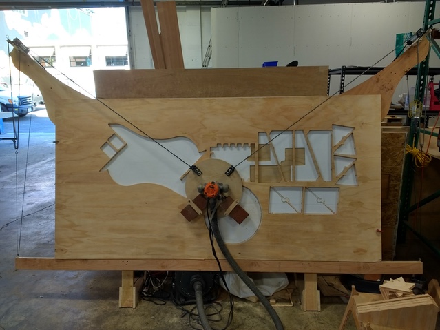

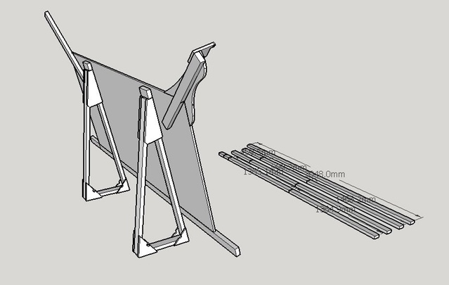

Another place we’ve been incorporating community feedback this week is in the design of the machine frame. It seems like the community wanted a frame which was easier and quicker to build with conventional tools. We also needed a frame which was less susceptible to chain slipping. By incorporating aspects of machines we’ve seen the beta testers build, we’ve made a frame which I think will be both simpler to build and (if initial tests stand up over time) less prone to chain slipping.
 The CAD model showing design changes
 Overview of frame in real life

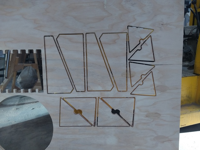

Less plywood more 2x4. We’ve added more parts made from 2x4 and removed some made from plywood. This reduces the total part count significantly, and especially reduces amount of time cutting parts. The new design requires eight fewer leg braces and two fewer arm cut outs.
 All the leg braces needed now

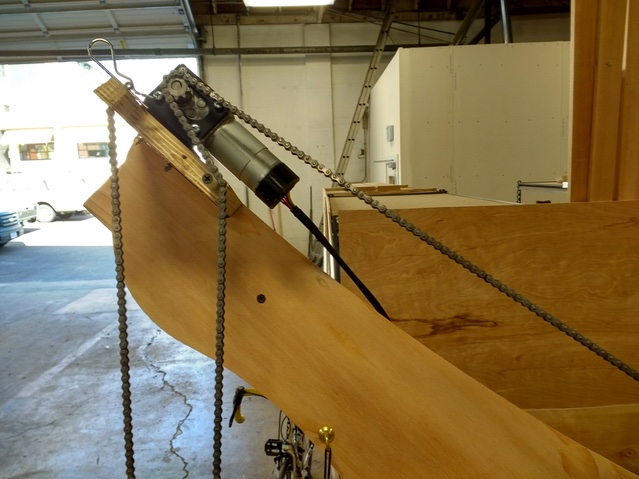

Forces in plane. By rotating the motors 45 degrees we can align the motor mounts with the forces on them making them less likely to flex meaning the chain can feed more smoothly.
More chain wrap. The new design allows for more chain to be wrapped around each sprocket, reducing the chance of chain slips.
 New arm close up
New arm close up
Constructable with hand tools. The new design is easier to construct without a CNC router meaning we may be able to do away with constructing the temporary frame altogether as a step in the assembly process. Note, the CNC cut front part of the arm is largely aesthetic, the arm can function without it.
I will be working on writing up complete step by step assembly instructions for the new design. Until then, feel free to take a look at the CAD files on GitHub here: https://github.com/MaslowCNC/Mechanics

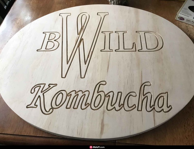

 This Kombucha sign was made by blsteinhauer88
