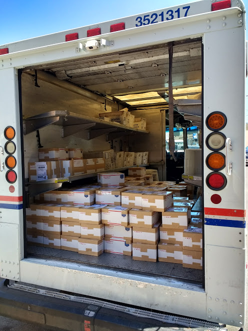

First and foremost, we’re excited to announce that ALL of the batch one kits have been sent out and are making their way around the world to your doorstep. We know that kits we started shipping last week have already started to arrive, so as you are getting your machine and putting it together, don’t forget to let us know if you see ways we can make the process easier or more clear, and most of all don’t forget to post pictures of the things you build!
We’ve also shipped almost all of the batch two kits, and those are starting to arrive as well. Unfortunately one of the shipments of motors we received from the manufacturer was a few motors short so we’re waiting on the the rest of those to arrive to finish shipping batch two. Fortunately, the factory was able to track down the missing motors quite quickly after we contacted them so we don’t have to wait for more to be manufactured, only for the ones which were already made to be shipped to us which shouldn’t take more than ten days. This small delay in the remaining motors means that we have to delay our shipment to the school winners as well. We’ll be sending the school kits with the remaining batch two kits.
 The final load going out.

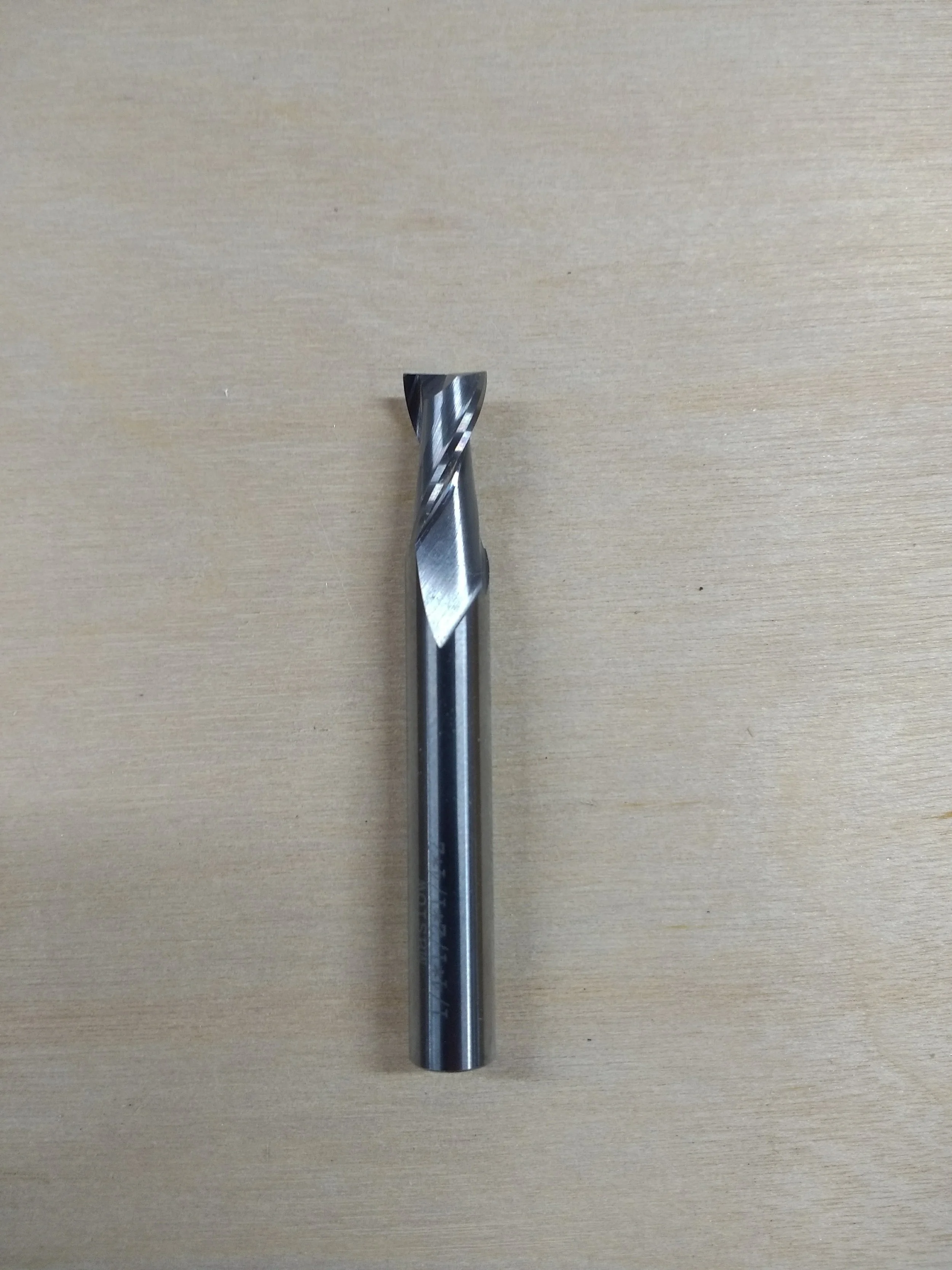

Solid tungsten carbide ¼ inch two flute up-spiral bit
This is the basic bit that we’ve been recommending when we get the question “which bit should I use”. It’s versatile, very forgiving, and works well with most materials. This is a good bit to start with. $8.99

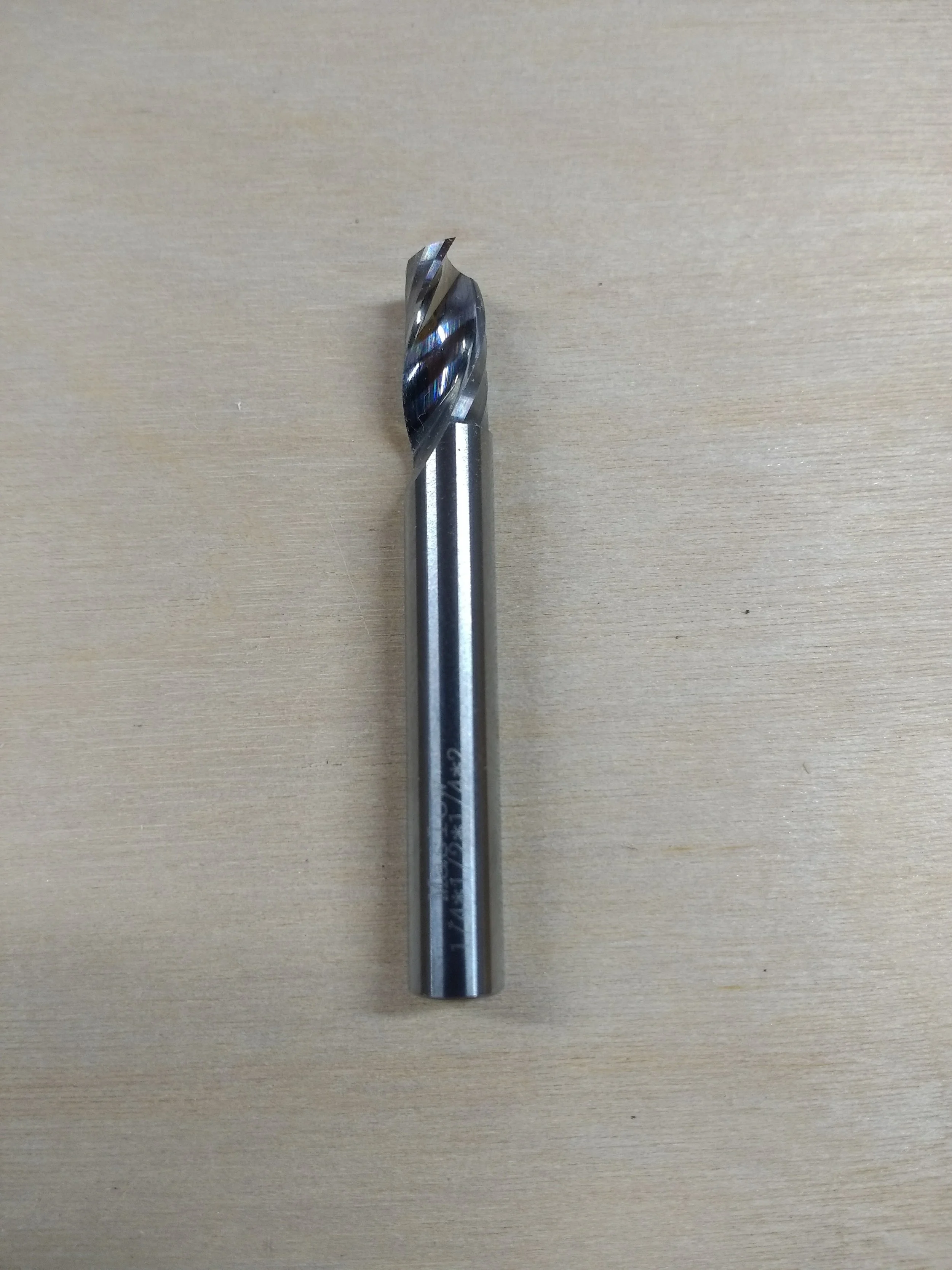

Solid tungsten carbide ¼ inch single flute up-spiral bit
Similar to the the tungsten carbide two flute up-spiral bit, but with only a single flute. Using a single flute means that for the same rotation speed and forward speed as the two flute bit, the single flute takes twice as big of a “bite” with each rotation. This can give you a cleaner cut or reduce burning in some materials. $11.99
