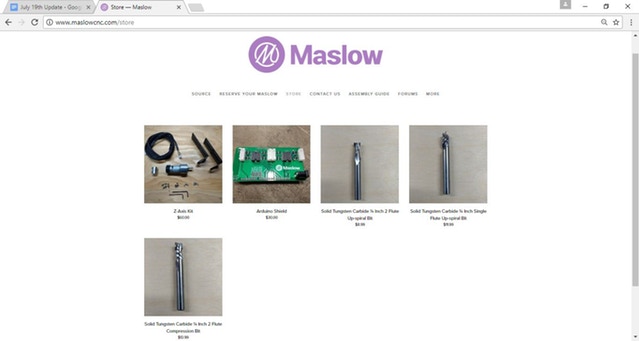

Router bits and replacement Arduino Shields available in the store, more replacement parts to come
We heard from the community that we need a good source for affordable router bits, and when we couldn’t find one we contacted a machine shop and had router bits made to our specifications. We also heard from the community that the Arduino shield is a part that people would like to purchase spares of so we’ve made those available also. You can buy router bits and spare arduino shields from our website at www.maslowcnc.com/store right now!

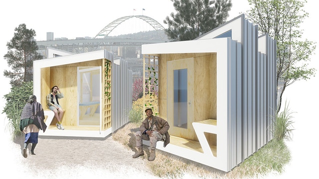

 A rendering of what the finished POD will look like. Image courtesy of SERA Architects

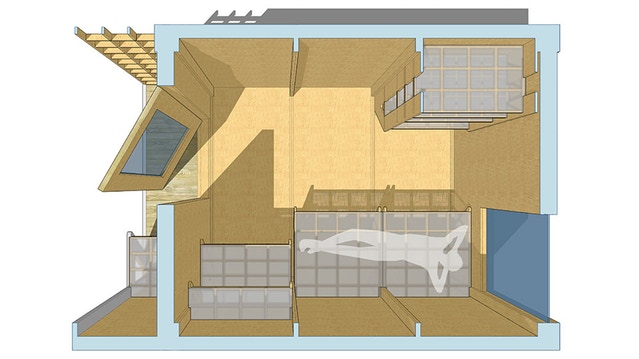

 The interior of the POD. Image courtesy of SERA Architects

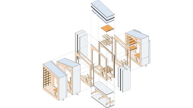

 A diagram showing how the POD goes together. Image courtesy of SERA Architects.

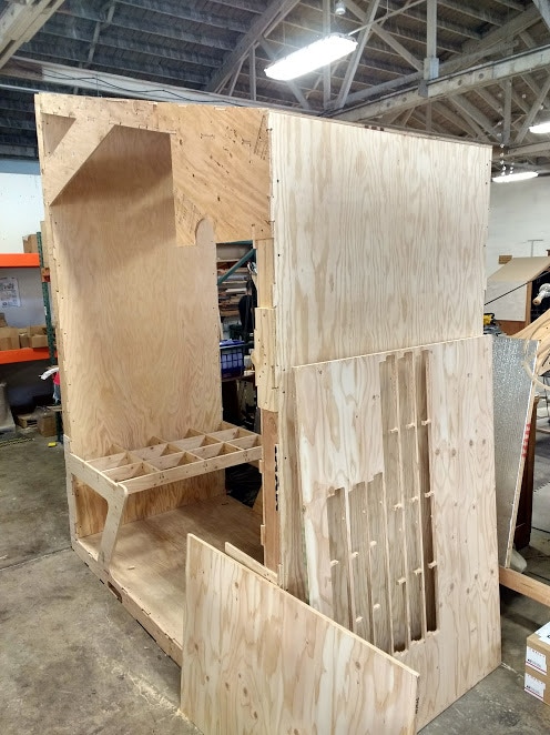

 The exploratory module we built this week from the CAD model
This project pushes the limits of what Maslow can do in big ways. One of the big challenges of this project is that all the parts are aligned with tabs. Calibration (as I’m sure you know by now) has been an ongoing struggle for us, and this project forces us to be sure everything is precise and aligned. Even a small error will magnify over a ten foot span to become a significant issue, and that is exactly what we saw this week.
 I was sure that I had my calibration dialed in. My straight lines were straight, my squares were square, but then something strange happened when everything went together. The tabs at the top aligned perfectly.
The tabs at the bottom aligned perfectly.
 The tabs at the bottom aligned perfectly. Ignore the switch to ¾ plywood, this is a test build so we’re playing with different materials.
But in the middle the tabs were off by at least ¼ inch.
 In the middle one of the tabs was suddenly off
The problem repeated itself on each of the four edges, with the same tab in the same place being off. I was stumped. The only explanation I could think of was that while my squares were square and my straight lines were straight, things were somehow being stretched.
I tested the theory that long objects were getting stretched by cutting a 1 inch by 70 inch rectangle, and found that my rectangle was 1 inch by 70-1/4 inches.

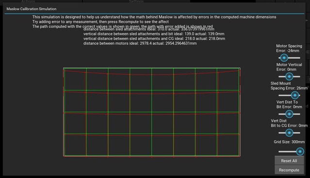

To track down the what was happening I wrote a simulator which will let us see how distortions in the measurements of the machine will result in distortions to the parts cut. The simulator is available in this week’s version of Ground Control, you can play around with it yourself by clicking Actions -> Advanced -> Simulation.
 The new simulator
The new simulator
The simulation lets you add a simulated error to each of the calibration measurements and then shows the correct grid in green, and the effect of the simulated error in red.
After a few minutes of playing around I found out that that if both the Motor Spacing measurement and the Motor Mount Spacing measurements are off by exactly the same amount, the type of stretching I was seeing occurs. I adjusted the measurements in my machine’s settings, and suddenly my 1 inch by 70 inch rectangle was suddenly actually 1 inch by 70 inches (at least to the best of my ability to measure). Hopefully in the near future, we’ll be able to integrate the things we learn from the simulator into an improved calibration process. Possibly a process which requires only a single set of strategic cuts and measurements instead of the current process of repeated cuts and measurements.
I haven't had a chance to do enough testing to say that the misaligned tab is completely solved, so expect an update on this issue and any other we run into next Wednesday.
