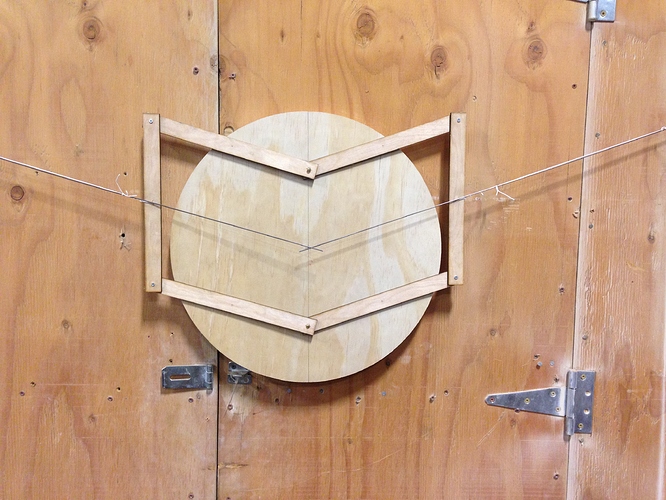

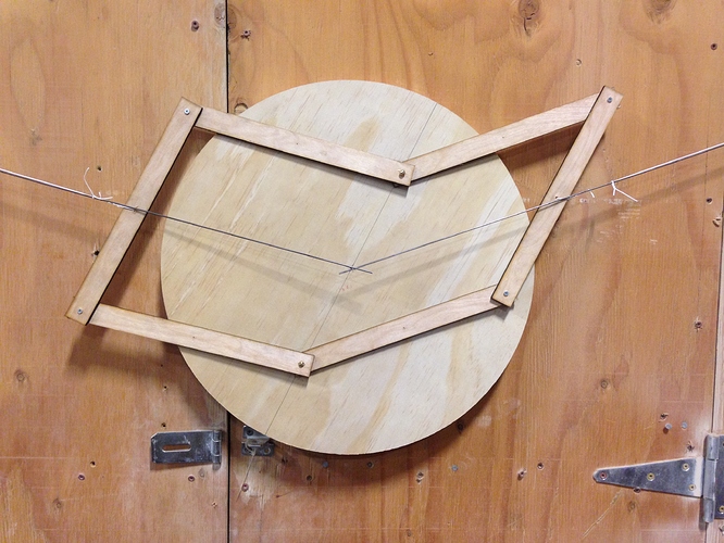

Within a matter of days the community came up with a system of linkages to achieve the same effect at a potentially even lower cost, and that’s what I want to share with you guys this week. To be totally clear, this system of linkages is the community’s idea pioneered mostly by Logan Needham, and tested by Kevin Keegan.
The general principle is that a system of straight linkages can simulate the same motion as a larger bearing at a fraction the cost. They’ve already come up with the idea, built it, and are testing it. Here’s some photos and footage from the testing process:
The design as conceived and tested by Logan Needham:
