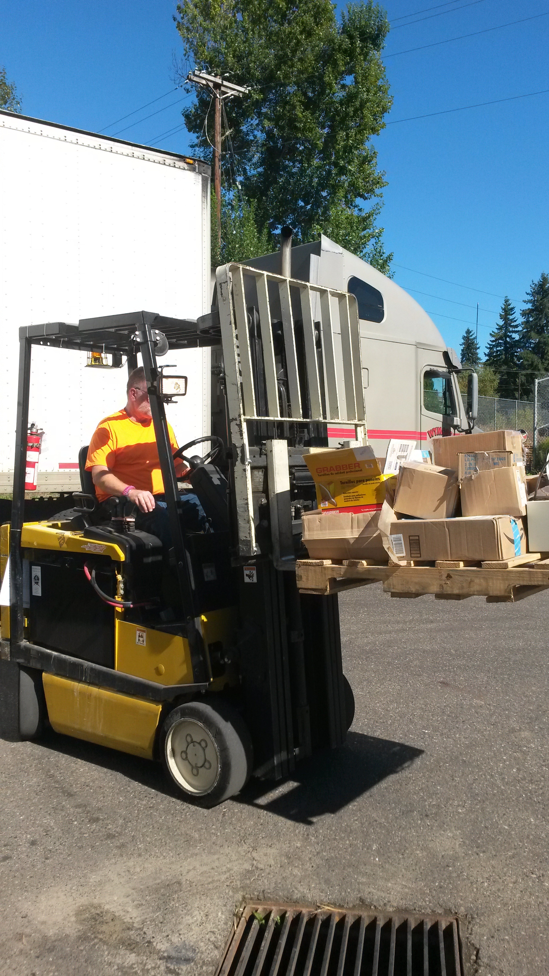

 The second load of stuff being forklifted off the truck.

 A forklift driver at Exceed moving many random items into the warehouse.

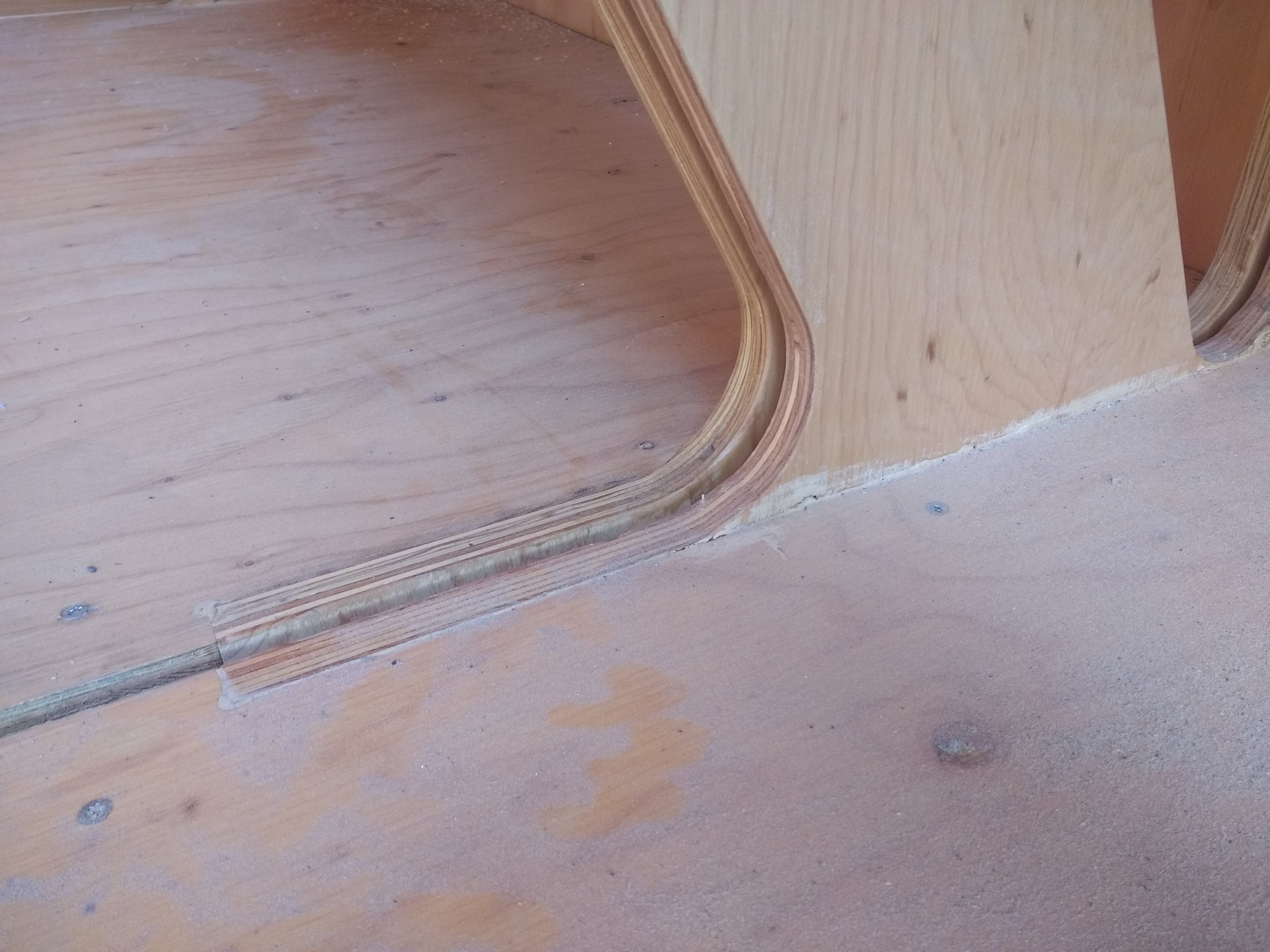

Building a house in sections has been an interesting experience. The structure is designed to be taken apart and moved with a forklift. It was really cool to see the three sections fit together despite the fact that we didn't measure anything, we just cut out the parts and started assembling.
  For the most part, the things which should line up are lining up

We are especially relieved that all the parts have lined up since each section was basically built on a different machine. The first section was built on the original Maslow where the chains anchor at two separate points. It took us about three days of cutting to get all the parts.

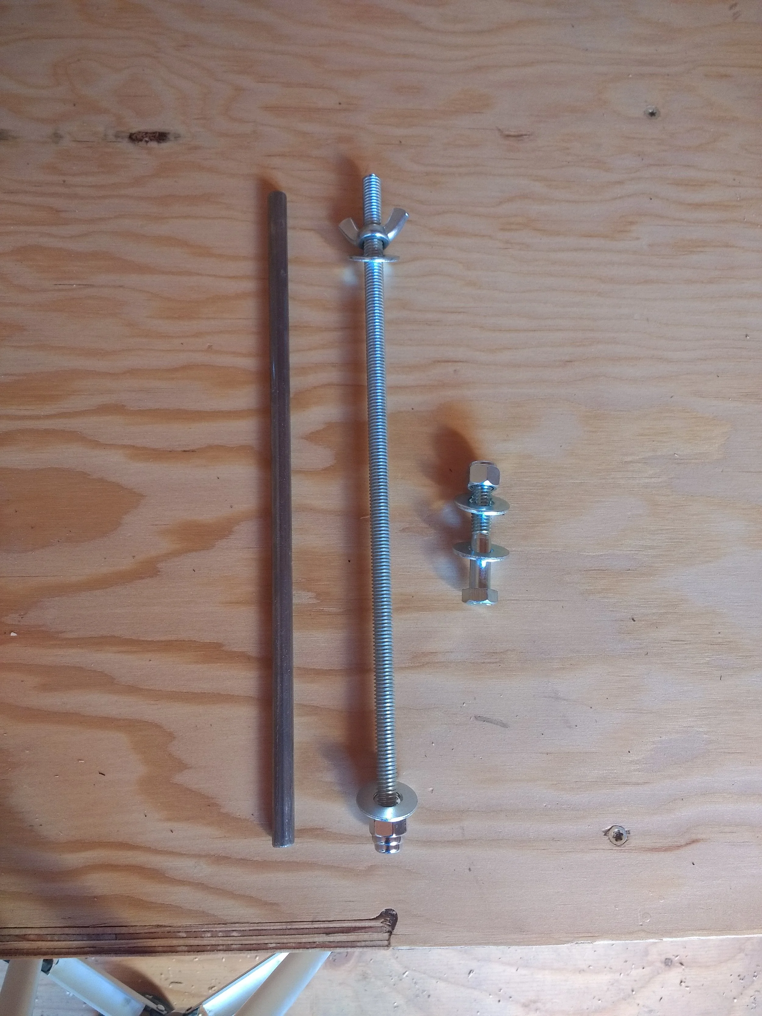

Another interesting challenge has been getting the modules joined. They’re too big and heavy to move with anything other than the forklift, but the forklift doesn’t have the finesse to get all the bolt holes aligned (and the parking lot is far from level). Our first solution was to make ⅜ inch steel pins which we could put in the bolt holes to guide the parts into place. Even using the pins to guide the modules together, the forklift still didn’t have the needed finess. The final solution was to replace the steel pins with threaded rods and to pull the sections together by slowly tightening them. Once the modules were joined, the threaded rods were removed one at a time and the final bolts inserted. It was tedious, but it worked.
  The steel pins, threaded rods, and final bolts we used to get the modules together
