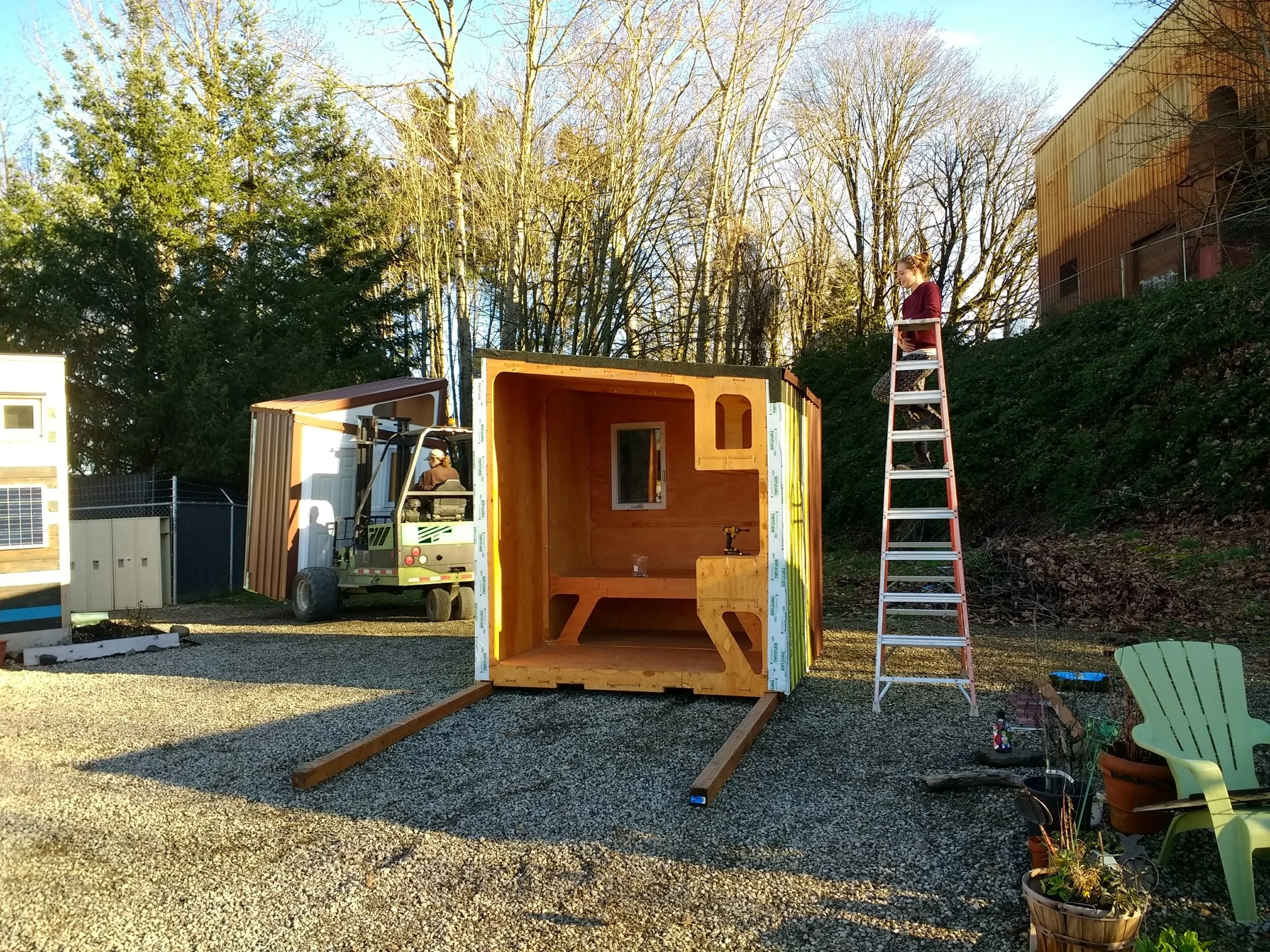

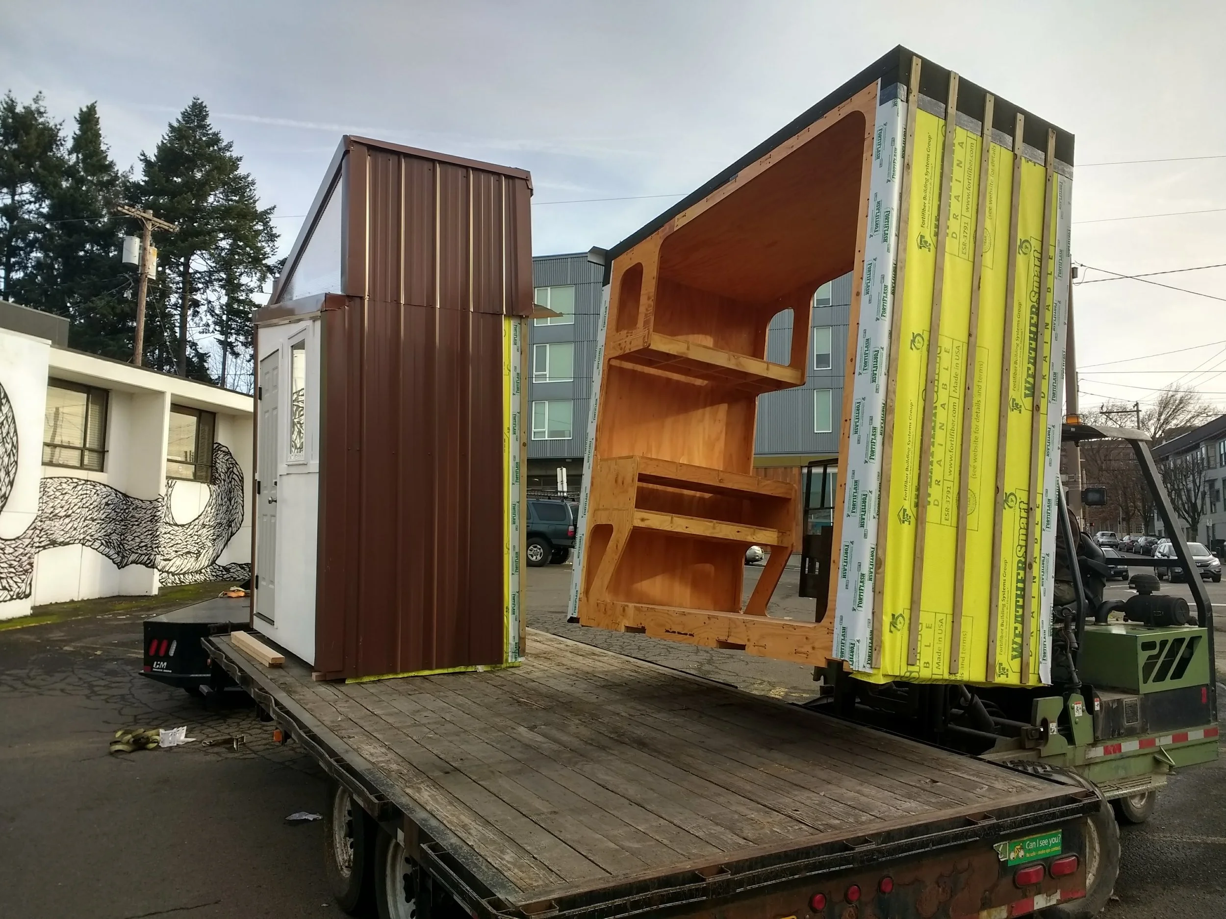

On Saturday we delivered the PlyPAD to its permanent home at the Kenton Women's Village. The reception there was overwhelming, and it felt really good to finally get to deliver that project. Overall the delivery went really well. The sun came out, which is unheard of for January in Portland, and the sections which we struggled to get to bolt together in our sloped and uneven parking lot went together easily. We would like to say a huge thank you to The Rebuilding Center for letting us use their truck and forklift to move the pod. We never could have done it without them.
 Loading the POD onto the flatbed truck early in the morning before the parking lot could fill up
 Sections 1 and 2 bolted together with section 3 coming around the corner
 Hannah guiding section number 3 into place

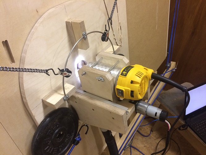

Just as cool as the stand itself are some of the modifications that he made to his machine.
 Here you can see Brr’s custom made ring system and z-axis setup
 Brr has also been experimenting with two extra cables which are linked to the chains with a system of block and tackles to provide extra tension

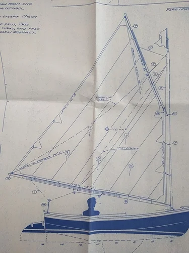

In what must be the most amazing thing built by Maslow to date, Sonny_Lacey built a boat! (Or at least a very solid start on one). The design is for a Bolger Bobcat sailboat based off of purchased plans. The plans were then digitized using Fusion 360 and cut. Sonny_Lacey has some excellent advice on that process in his forum thread here.
 How the Bolger Bobcat will look once it is finished
