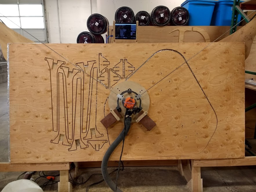

Maslow is a large CNC router which lets you download and build big things. CNC routers have been around for a decade but Maslow uses a unique design to reduce the cost by a factor of 10 or more (with some sacrifices).
Maslow started as a Kickstarter and has grown into a healthy and collaborative open source project with hundreds of contributors. As a community we have faced and tackled a number of major technical problems. We’ve moved from the realm of “is what we are trying to do possible?” to the realm of “can it be better?”
Maslow CNC Router
Maslow CNC Router

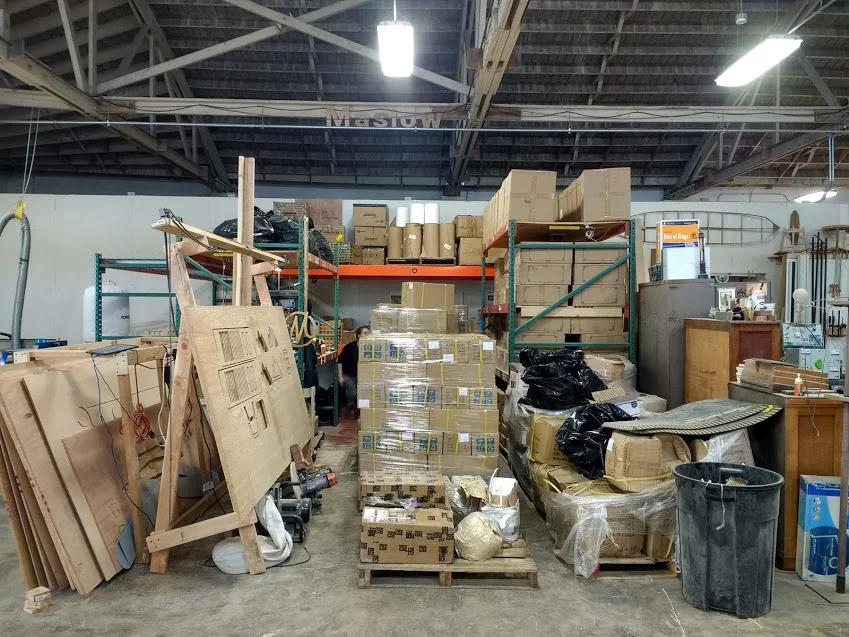

Maslow HQ
Maslow HQ

CNC Cut Dish Rack
CNC Cut Dish Rack
