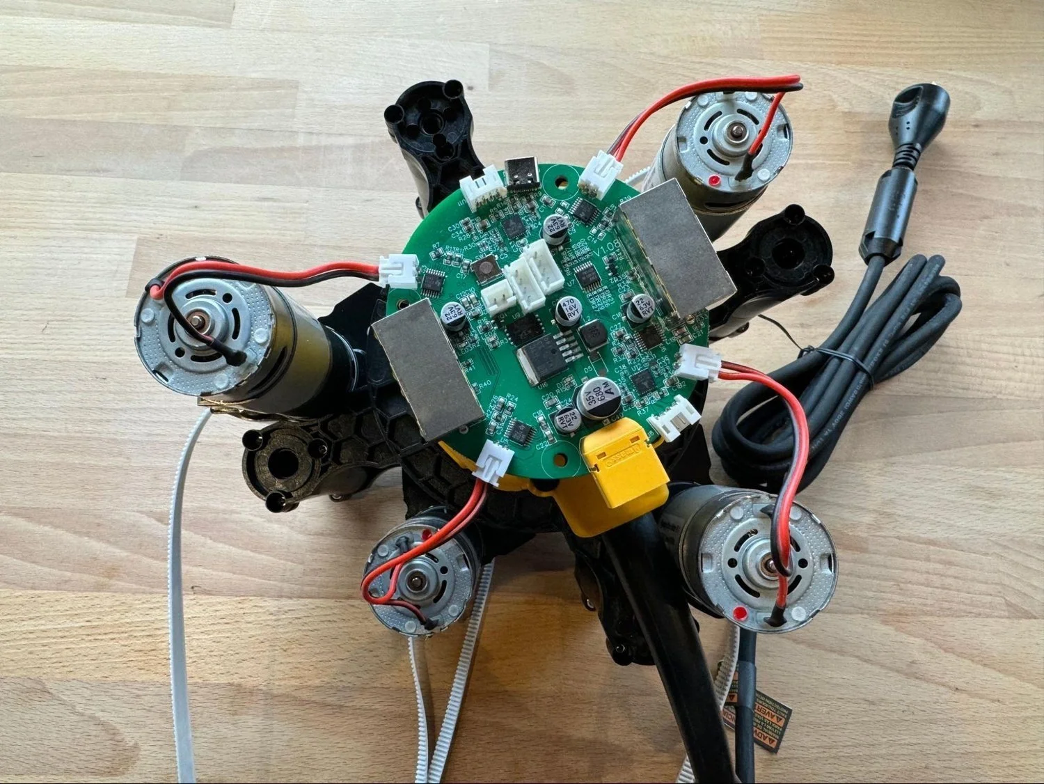

Place the main controller board on top of the router and plug in the four motors.
Quick edit here. I will need to re-photograph the rest of this section, but until I have a chance to, the six heatsinks are attached to the tops of these six chips.
Use the four ethernet cables to connect the encoders to the controller board.
