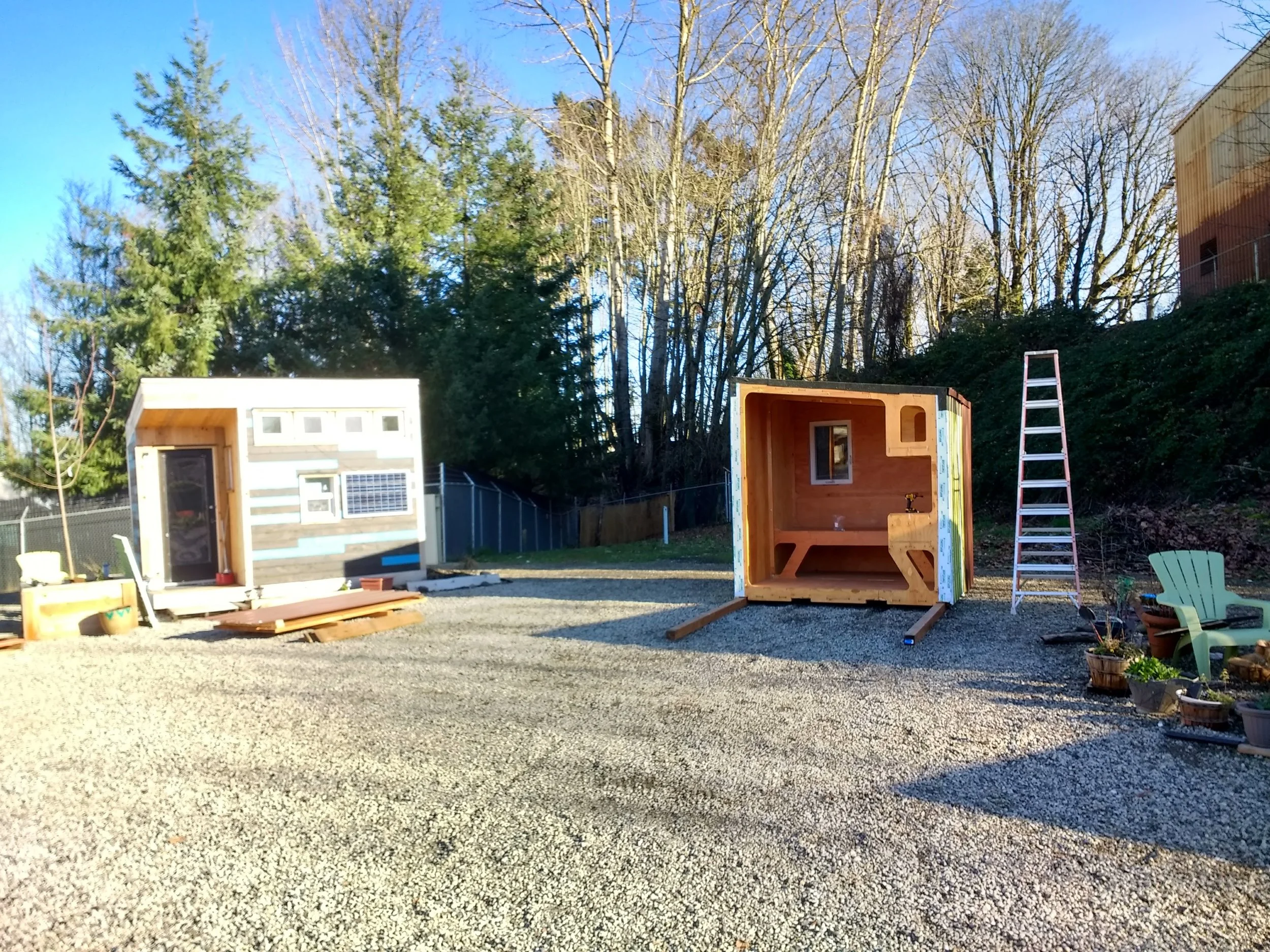

Over the course of many hours between July and October of 2017, we worked with SERA to build their PlyPAD. With the tiny home now finally about to be moved to the Kenton Women's Village, we're happy to tell our story and say that we were apart of this amazing initiative. Designing and building a CNCed tiny house is no easy task, though, so we want to share our photos, story, and lessons learned so that hopefully those working to build CNCed tiny houses in the future can have an easier time than we did. We believe sharing the knowledge we gained from this endeavor is paramount in moving toward making CNC technology more accessible to everyone.

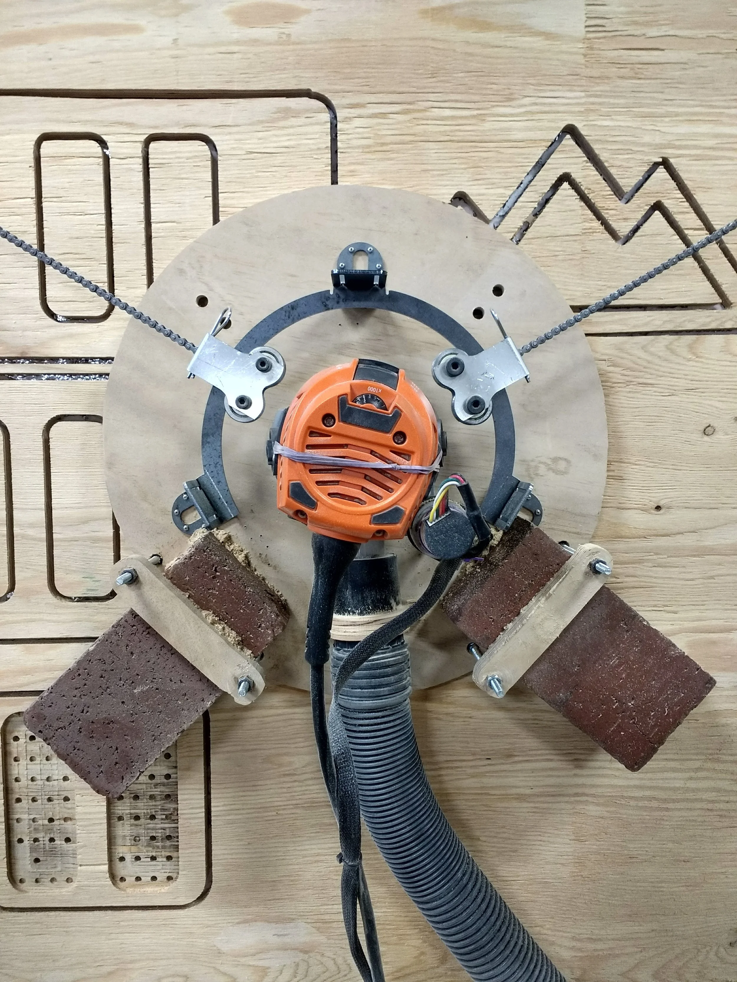

As a very small business, one of the ways that we justified considerable time and money invested in the PlyPAD project was as a way to test Maslow's capabilities, and improve the design. In this capacity, the project was a huge success.
The PlyPAD was a tough project for Maslow. It has a very large number of parts, all of which need to fit together precisely. One of the big struggles with Maslow has been calibrating the machine so that the cut parts come out precisely to the desired size. A 12' tall box joint like the ones which make up the edges of the PlyPAD are very susceptible to any inaccuracy in the parts.
This was something we struggled with in the initial parts of the building process. We improved the calibration routine, but that still wasn't enough.
Ultimately, we made what we think is a big step forward for the project and switched from a quadrilateral kinematics system where the chains anchor to two separate points on the sled to a triangular kinematics system where the chains virtually meet at a single point.
The original quadrilateral kinematics system where the chains anchor to two points on the sled
Our new ring system, where chains point to a single spot - the router bit.
