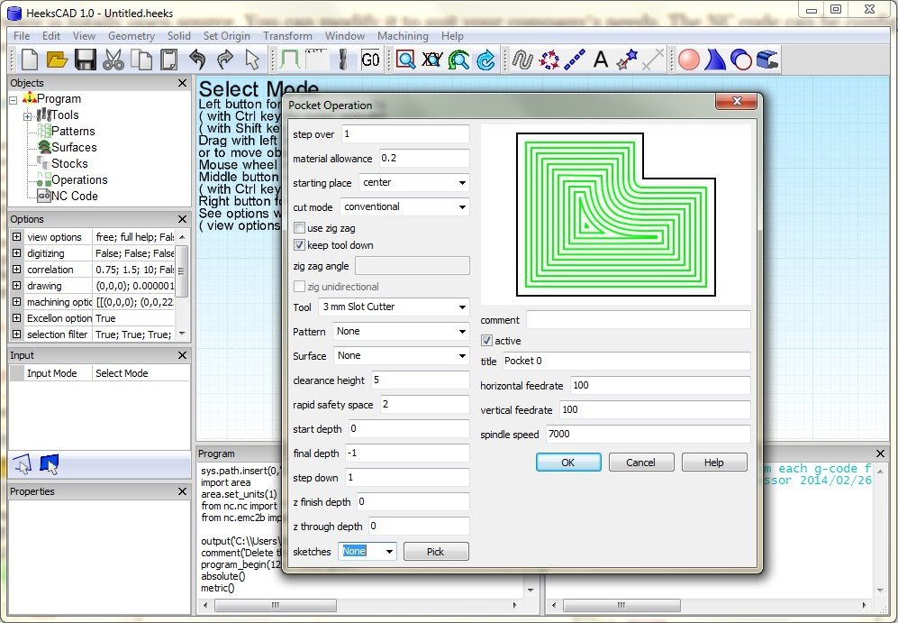

HeeksCNC is paid ($10 to own) CAM software which handles a large number of file types and can do 2D and 3D work. Windows only.
