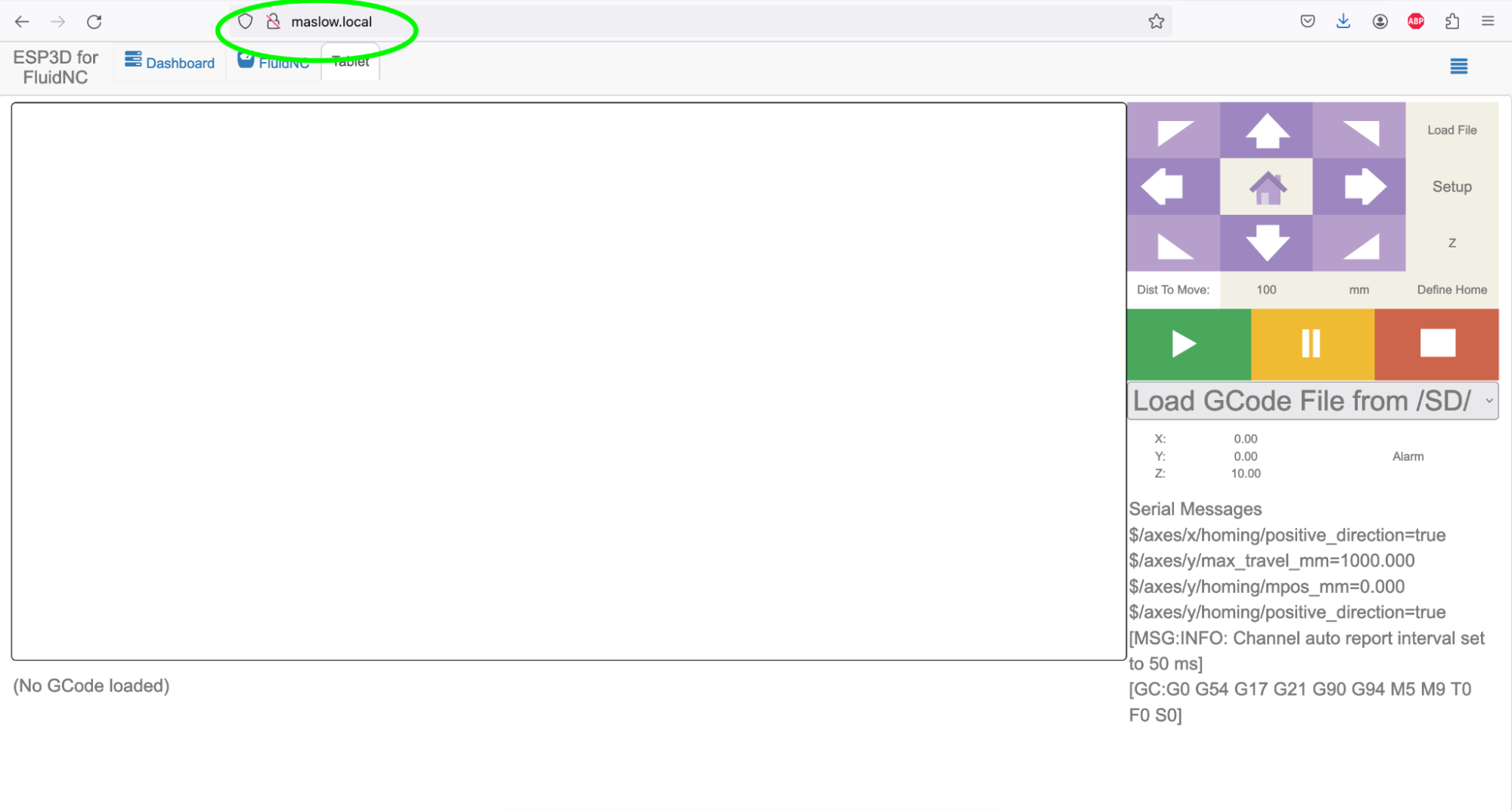

Maslow4 is controlled using a built-in interface accessible from your web browser. You can connect to Maslow4 from any Windows, Mac, or Linux computer or iOS or Android tablet or phone. You do not need to install any software.
Maslow4 will create a wifi network called “maslow” which you can connect to. The default password for this network will be “12345678”.
Connecting to the network will automatically open the user interface on most devices. If it does not you can type 192.168.0.1 into your web browser to open the interface.

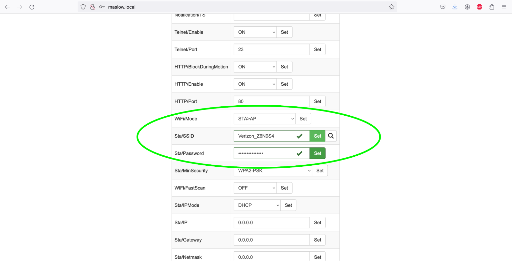

If you have an internet connection in your work space, it might be nice to connect Maslow4 to your existing WiFi network so your computer can stay connected to the internet and Maslow at the same time.
To connect your Maslow4 to the internet click on the FluidNC tab
Then scroll down to enter your WiFi network name in the Sta/SSID field and your network password in the Sta/Password field, then press set next to each field. You will need to restart your machine for the changes to take effect.
When your Maslow4 turns on it will attempt to connect to your WiFi network. If it is not able to find your network it will create a wifi network called “maslow” for you to connect to.

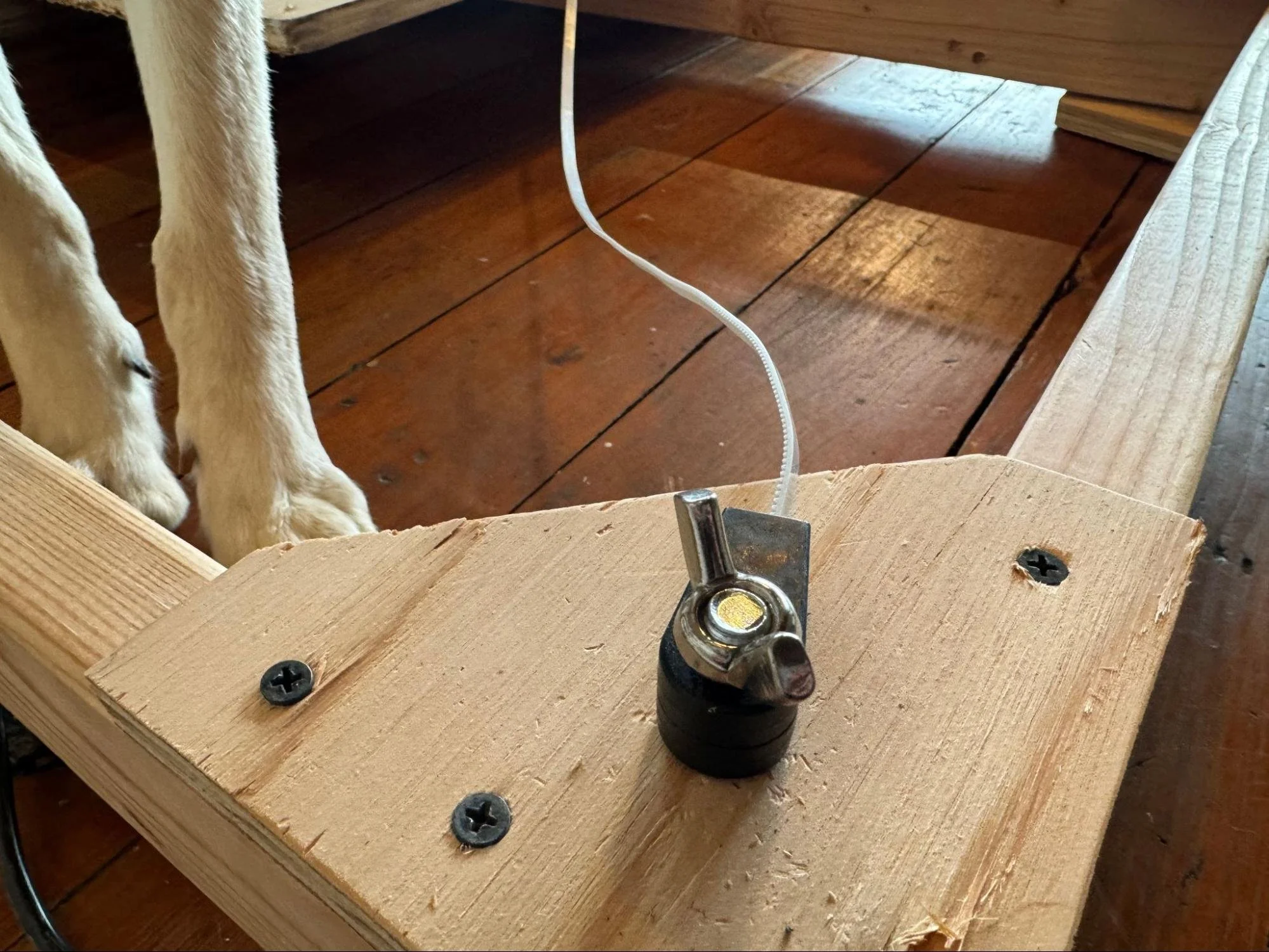

Attach all four belts to the frame. This might look different depending on your frame design.

You can move your Maslow around using the arrow buttons on the right side of the screen.
The distance that it will move can be set by clicking on the distance number.
You can switch between mm and inches by clicking on the units.

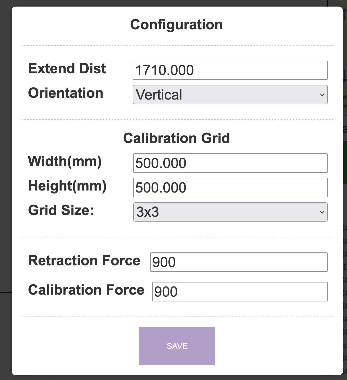

Maslow_Retract_Current_Threshold: 1300 sets the threshold to be used to detect when the arms are fully retraced. If your arms are not retracing all the way when you press the “Retract All” button try increasing this value. The maximum is 4000.
Maslow_Calibration_Current_Threshold: 1300 sets the tension used when taking measurements during the calibration process. Generally not a good idea to change this one.
