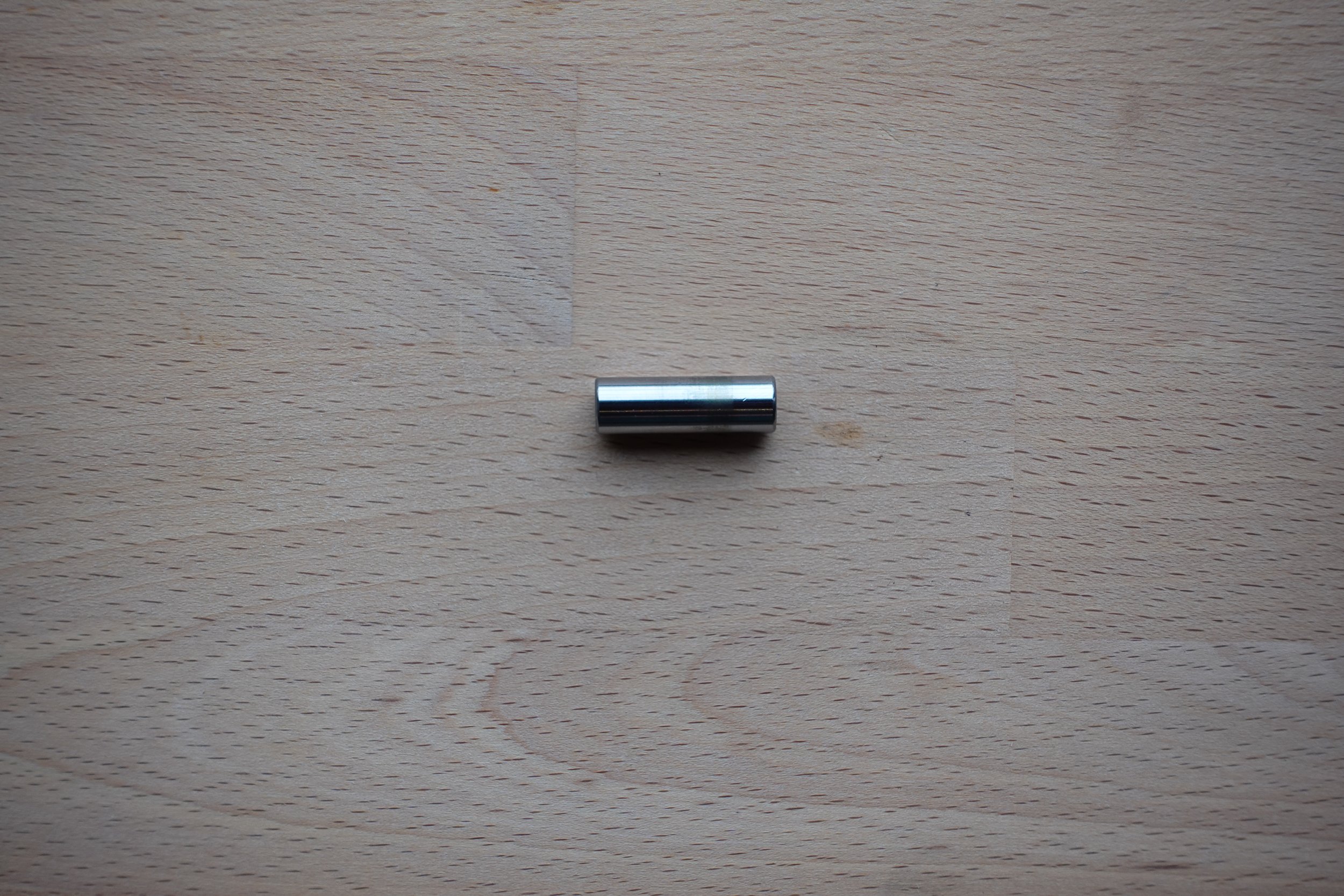

Idler Shaft. Quantity 4. Properties: Hardened steel.
