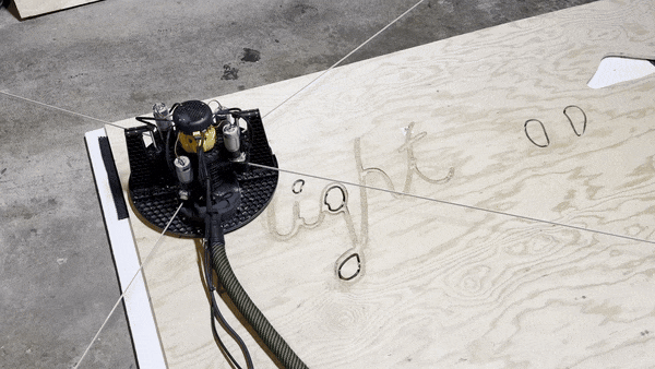

This week I cut out a miniature greenhouse to go on top of a raised planter bed, and a sign for a friend who is helping to organize the Folk and Forage music festival.
With both projects I tried to push the limits a bit with good results.
The sign was cut from 5/8ths ACX plywood in two passes at 2000mm/min which is a bit more aggressive than I usually cut, but it worked well other than the dust collector not being totally able to keep up, although it seemed to usually clear out the extra chips on the second pass.

Unfortunately, part way through cutting a planter box this week my foam spoil board shifted which partly ruined the cut. The issue was that my foam spoil board wasn’t heavy enough to grip to the concrete and also it had lost some of its gripping pads due to me 1) not having the right glue, and 2) not having enough non-slip pad to cover the whole surface.
I took the opportunity to make version two of the spoil board which has a couple of improvements. First the entire surface is covered in non-slip material. Second, I staggered the layers making it slightly larger than 4’x8’ so that I can easily support the sled when cutting right to the edge. Third, I made the whole thing from plywood to give it some extra weight.
Overall I am happy with how it is working. The extra size is great, and having non-slip surface everywhere makes it super grippy so it’s not going to slide, but the extra weight of the wood does make it harder to move around and I’m worried the duct tape hinges aren’t going to hold up for long so I’m not totally sold on that aspect of it.
