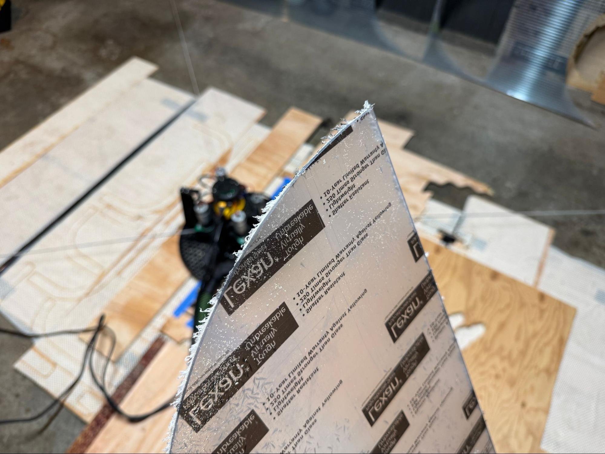

As part of testing this week I decided to cut out some clear plastic end windows for the planter box greenhouse that I made a few weeks back.
I’ve tried to CNC cut acrylic in the past and I’ve had mixed results with it melting and being hard to work with, so this week I decided to try cutting polycarbonate or Lexan.
It’s an incredibly tough material, but it turned out to CNC cut quite easily. I tested two types and both cut easily with a single flute router bit at 1500mm/min.
The first type that I tested is this hollow core panel which is specifically designed for making greenhouses and things like that.
It cut quite nicely. The channels between the layers filled up with chips, but they were easy to vacuum out.
I cut it with the protective peal ply on both sides which helped to prevent it from getting scratched. I was a little worried it might get tangled in the router bit, but that wasn’t an issue. I cut it in two passes.
Here it is with the peel ply removed.

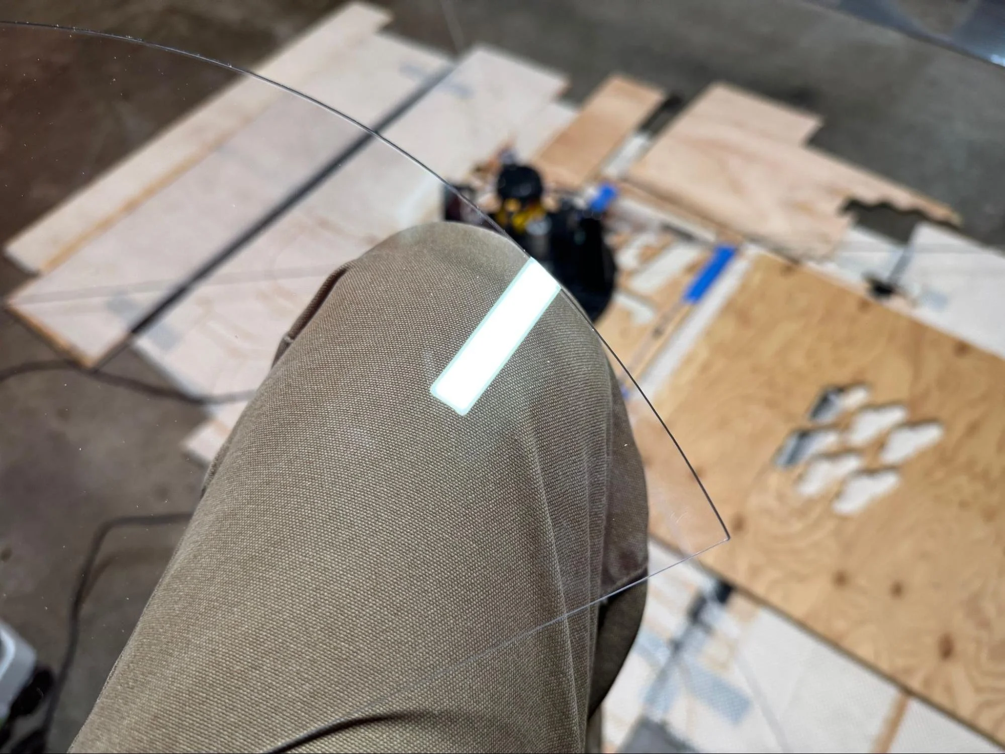

Next I tried cutting solid Lexan. It’s a bit pricey so I got quite a small piece and taped it to a bit of scrap wood. I didn’t get my home position exactly right so there is a small flat spot on the top of the part where it didn’t quite fit, but other than that it cut quite easily as well.
Again, the peel ply protected the material from getting scratched and I also cut this part in two passes.
Here it is with the protective film removed:

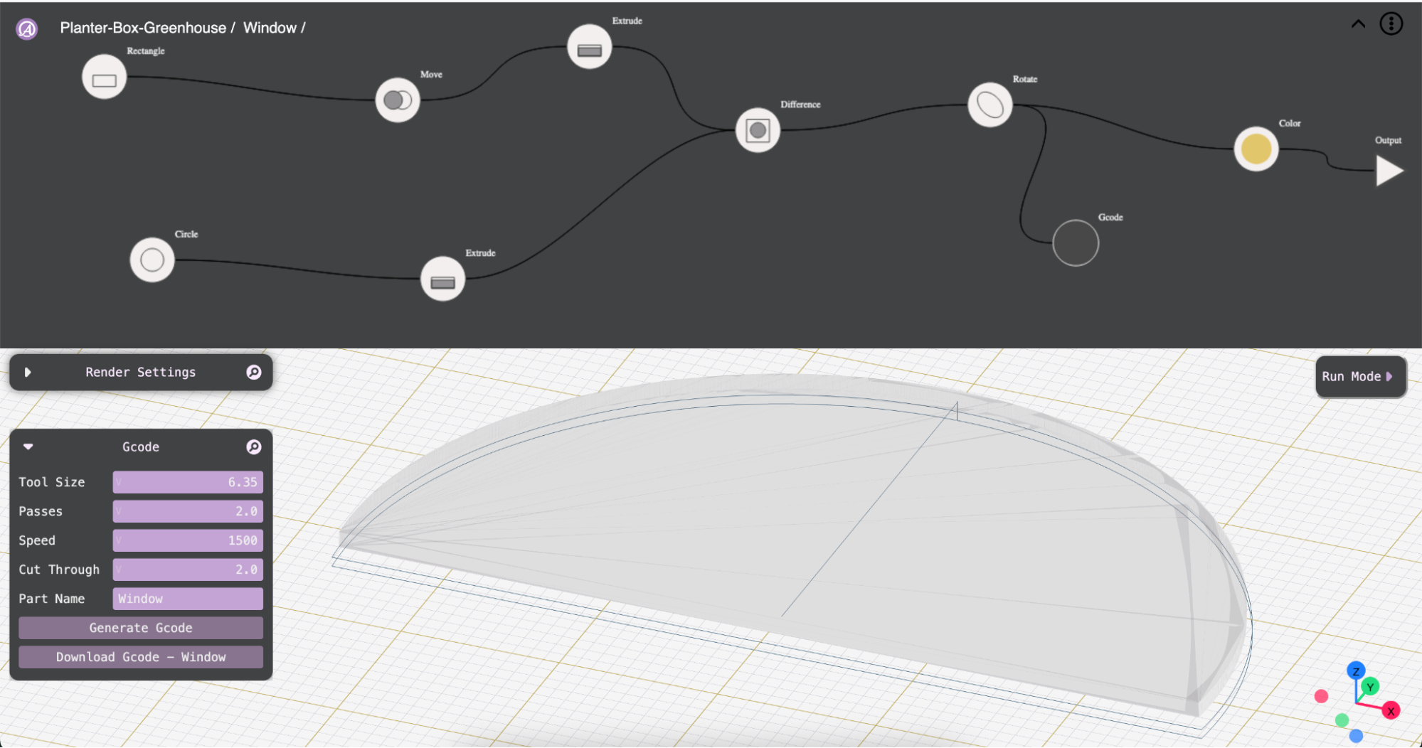

Excitingly, these Lexan parts were the first thing that I made using gcode generated directly in Abundance. That means the design was done in our free and open CAD software, the gcode was generated in our software, and the parts were cut on our machine.
There is a lot of work to do to make each of those steps easier and more user friendly, but it’s still an exciting first step.

Generate gcode directly in Abundance!
You can now connect your geometry to a gcode atom and generate gcode to cut it out directly in Abundance.
It’s still quite beta, we’re using the excellent KiriMoto gcode generation engine, but I think that we might be the first folks trying to use their API so we’re finding all the bugs. Overall I am very excited about how this is going to work out.
Because Abundance already has all the information about your material there is no need to click on any edges or select the depth of cut. We have some basic settings that you can change as needed, but for the most part the goal is to make things as simple and automatic as possible.
